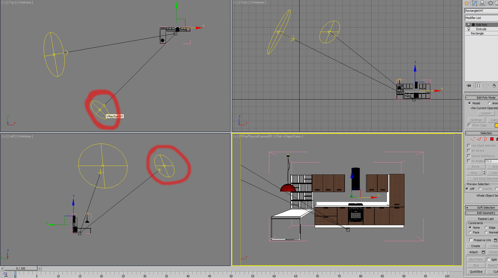

    I am normally working on my scenes when, suddenly, a "VraySun" is created.
    The thing seems to happen completely random, and i get aware of it only by the suddenly fully-clamped white viewport or, at worst, at render time. No errors, no freezing, no strange outputs of the macro recorder. Nothing. It just appears.
    This happened at least 7-8 times, on different files and different kinds of work (animations, architectural scenes with imported cads and fully "max-native" scenes). It happened in scenes where the sun+sky wasn't even ever used, and on more then one pc; one of them was a bare max+vray render node, with no plugins, scripts or other stuff on it.
    Any clue? I'm currently using vray 2.20.03, and i often use vrayRT.

                    it happened again.
                    a new sun appeared.
                    the only thing I did was to import a simple vraymaterial ( a light gray..so no textures) from the material editor. The file from which I took the material does not have the sky nor the sun.
                    I realize that there are 2 suns on stage only at the rendertime because I usually hide lights ( after finish placing) .

                      after writing th last post i tried to delete the extra sun. Here my steps :
                      1) I deleted the old VRaySky from the environment slot
                      2) I deleted its instance from the material editor ( so no sky at all)
                      than...
                      3) I left my sun in the scene called "SOLESTRO" capitalized.
                      4) I create a NEW map Vraysky called "cielo" in the material editor.( i changed sun intensity parameter to 2). i choose my "SOLENOSTRO" sun.
                      5) I instanced it into environment slot.
                      .. i use 3dsmax "UNHIDE ALL" to see all object in the scene....and a new "solenostro" (write with no capital letters) is created!!!
