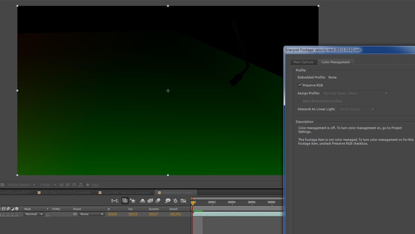

    This is how the channel looks like when used in AE - all other channels are ok!

    The default for velocity is signed (so things moving from right to left will cause negative values) so the negative part is eventually dropped by AE ? Also the element records velocity as pixels/frame by default, so values above one might also be clamped by AE
    Regards,
    Thorsten
      @Thorsten, sorry I don't get what you mean with the negative part in AE.
      I used the same settings (with headroom for the max veolicity in last frame) and the same numbers within RSMB in AE.
      What I don't get is with the same settings it works using multiple pngs as opposed to a single EXR.

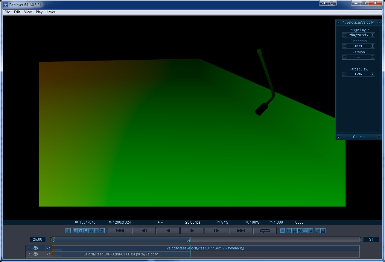

        I checked the EXR's in PDPlayer - in case AE is interpreting the EXR's wrong.
        But it's the same there. So it seems like a problem of Vray saving to single file EXR or EXR interpreting it wrong?

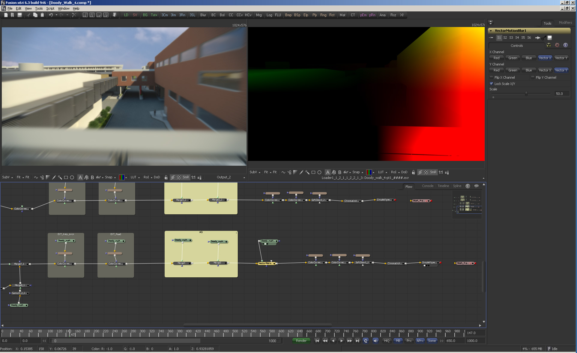

          I use single EXRs with velocity channels in fusion and everything works perfectly

            here is a screen grab of fusion showing that the velocity channel in a single EXR is working perfectly well.
            If you want to try one of my EXRs PM me and I will send it to you to try in AFX.

                  Looks quite different in the max VFB and that is because in fusion it is not showing the "blue" velocity information

                    You don't really need the blue part; most compositing software doesn't use it anyways.
                    Vlado
                      the way the exr looks in after effects appears correct. When vray displays the exr in framebuffer its placed against a neutral gray background. However if you are using a multichannel exr, the gray background does not get written into it, so you see Red and Green on pure black. If you simply take the image out of vray frame buffer and subtract 50% gray, you will get the same result.
