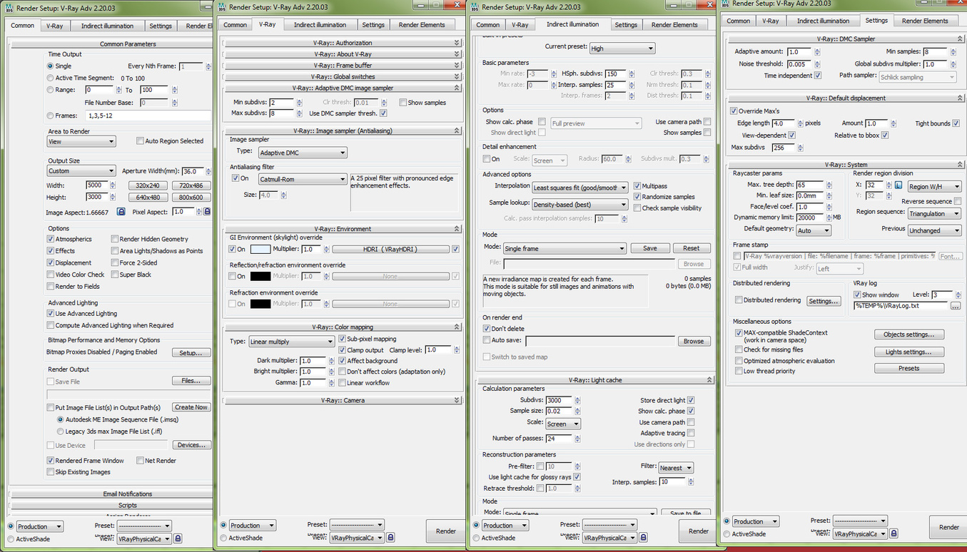

          Altho at the same time I don't get his "effect" in my original low quality / res Images....I also loose the burning of the internal spot lights, which makes me think I've lost it due to settings? Yes all the glass has 10mm thickness to it.

            Could you maybe also show your settings of your glass material?
            Default vray material should be fine with black diffuse, white reflection and fresnel ticked. For refraction a colour of 250,250,250 and make sure you tick affect shadows and "all channels" for refraction
            default of 1.6 IOR should be fine but you can make it 1.5 if you really want to.

              Your glass is slightly glossy and you've got 'use lc for glossy rays' turned on, so everything behind it is being handled by the lightcache. Check on your pre filter in the LC settings and raise the interp samples to 100, that should help somewhat.
              to be perfectly honest, because it's only slighty glossy it may be worth rendering it sharp with a channel to select it and blurring the refraction pass/re-building the glass in post. it'll be much faster and save any issues like this.
              Clearing all your smoothing groups on that object is going to split the reflections into vertical strips around the corner, i'm not totally sure you'd want that.

                  as cubicle says, those look like lc samples. if that's the case, you can even try and uncheck "use light cache for glossy rays".
                    Thanks guys for posts, I think your right, I used to have this option always ticked in my template file but I must of forgotten to switch it off, it does save loads of time but hardly a great result with the interp samples so low...

                      Yes thanks for everyone's input, yes it was the Subdivs / glossy rays problem, so switched it off and increased the Samples and looks peachy now! Cheers.
