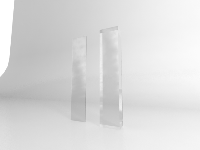

    Hello,
    i got this very simple scene, a base of a studio set up with a ground+wall and a thin and thick glass object
    when i render this, i have this strange ugly GI in the glass...
    simple omni, vray dome light, irr map and lightcache
    where is the problem ???
    Thanks!
    ps: attached jpg and max scene
    OK, found out that the simple background plane with a simple glossy reflection is messing up the tranparency/gi problem
    edit : simple reflection on that plane, even without glossy is messing up the transparency
    edit 2 : even without glossy, i have strange GI in the thick glass box...
    edit 3 : well... it seems whats messing up, is the vray dome light. When i turn it off, transparency is fine...
    is there a fix?
    thanks

        light cache is turned off... just irr map
          so brute force 2nd bounce?

            No, nothing as 2nd bounce (just to see where the prob is coming from)
            i tried with vraylight planes, even with 256 subdivs, and i also have strange gi effects in the refraction
              well...i think it's more irrmap related in a way...
              i changed the sample lookup to overlapping, instead of density, and result is much much cleaner !
                no idea then i'm afraid, I'm not much of an expert with irradiance maps!

                  (adding a light cache as 2nd bounce with default settings but telling it to use light cache for glossy rays (not ticking retrace threshold) seems to give a decent result)

                    You would need to enable Affect reflection option of the dome light on order to get a correct result.
                    Zdravko Keremidchiev
                      hmm..yeah but when doing that, i loose my custom panoramic env map i use for glass materials
                        What exactly are you trying to achieve?
                        Where do you set the env. map: domelight, environment or environment override slots?

                          i normaly place a 360° pano in the glass for reflections, and a kind of studio setup for lights and background.
                          so i just need clean transparency, GI, and light reflection in the glass

                            Hello there.
                            This problem can be fixed if you choose " Treat Glossy Rays as GI = Always" from "Options" rollout of your backplate material.
