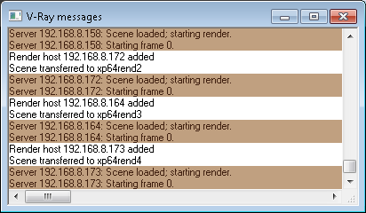

    I'm posting this in a new thread, even though I started it in other places, but I thought it warranted it's own topic. I have searched this topic, high and low, and tried everything. Most of the thread were unresolved, and none worked for me
    When I render a scene, low resolution with low setting, it works fine using DR. When I increase the settings, and the resolution, the slaves do not participate in the render. All my slaves get the scene transferred, but nothing ever happens. The below image shows where my V-Ray message window sits, and does nothing from there. All my slaves are running 90% ram, and 25% CPU, so something is happening.

    it could be that they are slower than your workstation so by the time the render is finished, they'r still thinking about lightcache
    try precalcing the GI on your pc only. Only then, using the saved precalc, do a DR.

      they never join, even when the render time on the main PC is hours. I can render 8.5 x 11 @ 300dpi without an issue. When I try to render out higher, it'll get stuck. I did get a virtual memory error on one of the slaves, but that shouldn't' hold everything up, should it?

            One of my slaves stopped responding, which seems to have been holding all the other slaves up. Is this normal? All of a sudden my PSD-Manager stopped responding, which was on slave 1. Slave 1 was up and running, I could ping it, but V-Ray said it wasn't responding, and so did PSD Manager. I un-plugged the network cable, running to slave one, and plugged it back it. Now everything seems to be working.
