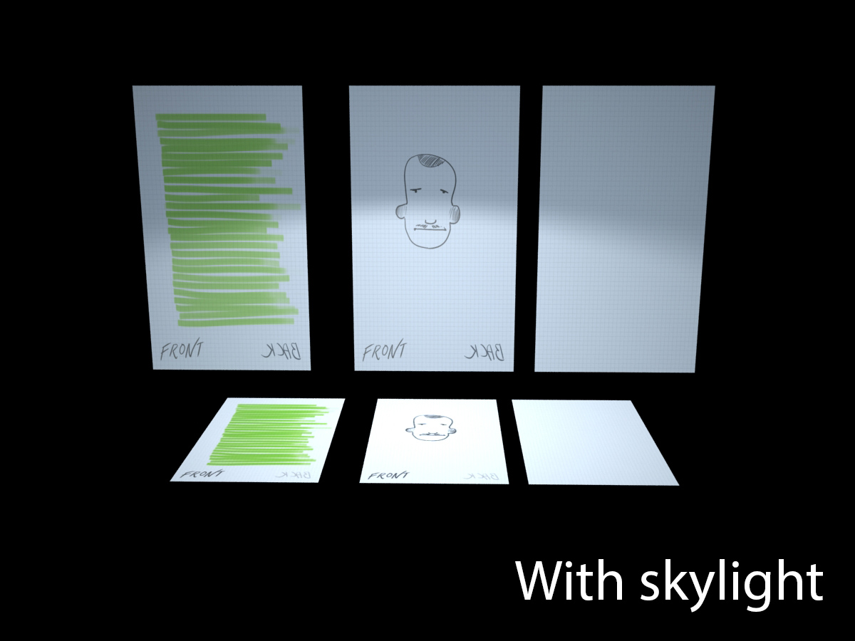

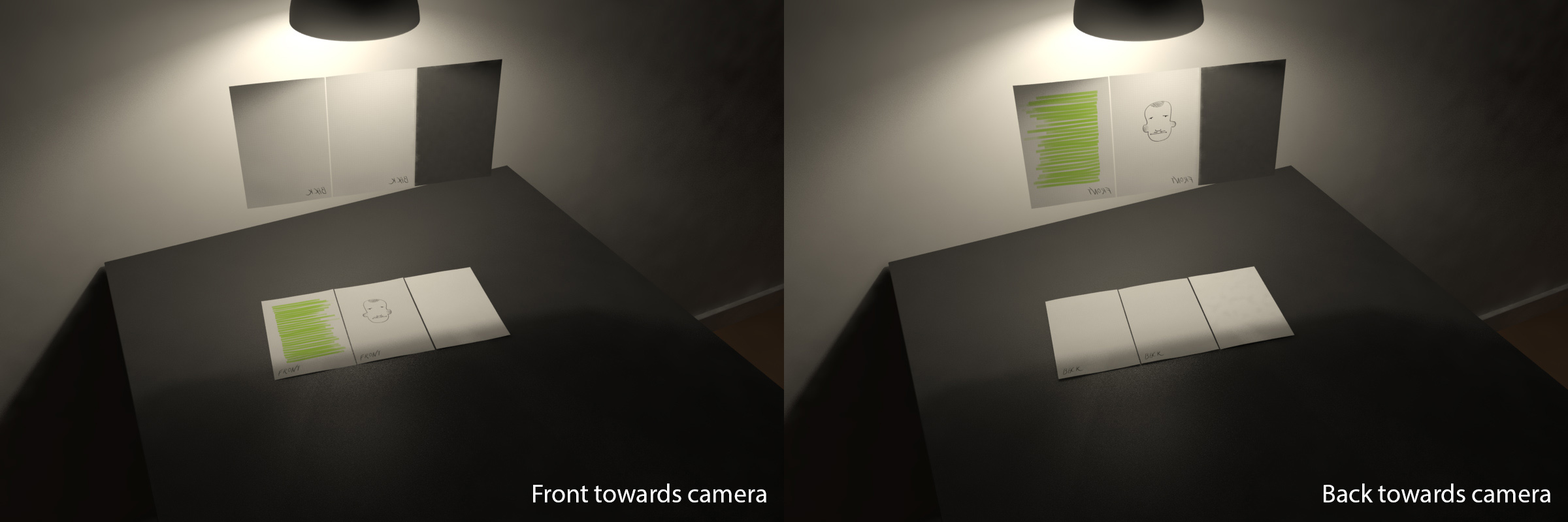

I constructed a scene to mimic the situation in my home studio. I modelled paper objects to mimic the real life papers. Textures looking like they do in the photos were also created.
I use three different Vray2sidedMtl for the papers. One with the green front, and a white backside. One with the face, and with a white backside. One with a clear paper texture, used as both back and front material. The translucency in these renders is set to 64RGB. (Using numbers over 128 will really make this look weird.)
In the render, the papers laying on the table look quite ok. However, the papers are a lot less similar to the opaque stack of papers when compared to the situation in the photo - they appear a lot darker in the render. This effect increases as you raise the level of translucency.
When backlit, you can now ONLY see the back facing material, and NONE of the front facing. In the photo the backlit papers look almost identical no matter the orientation of the paper to the camera.
I have tried changing translucency, but the that does not change the fact that the front facing texture is completely ignored when the paper is backlit.

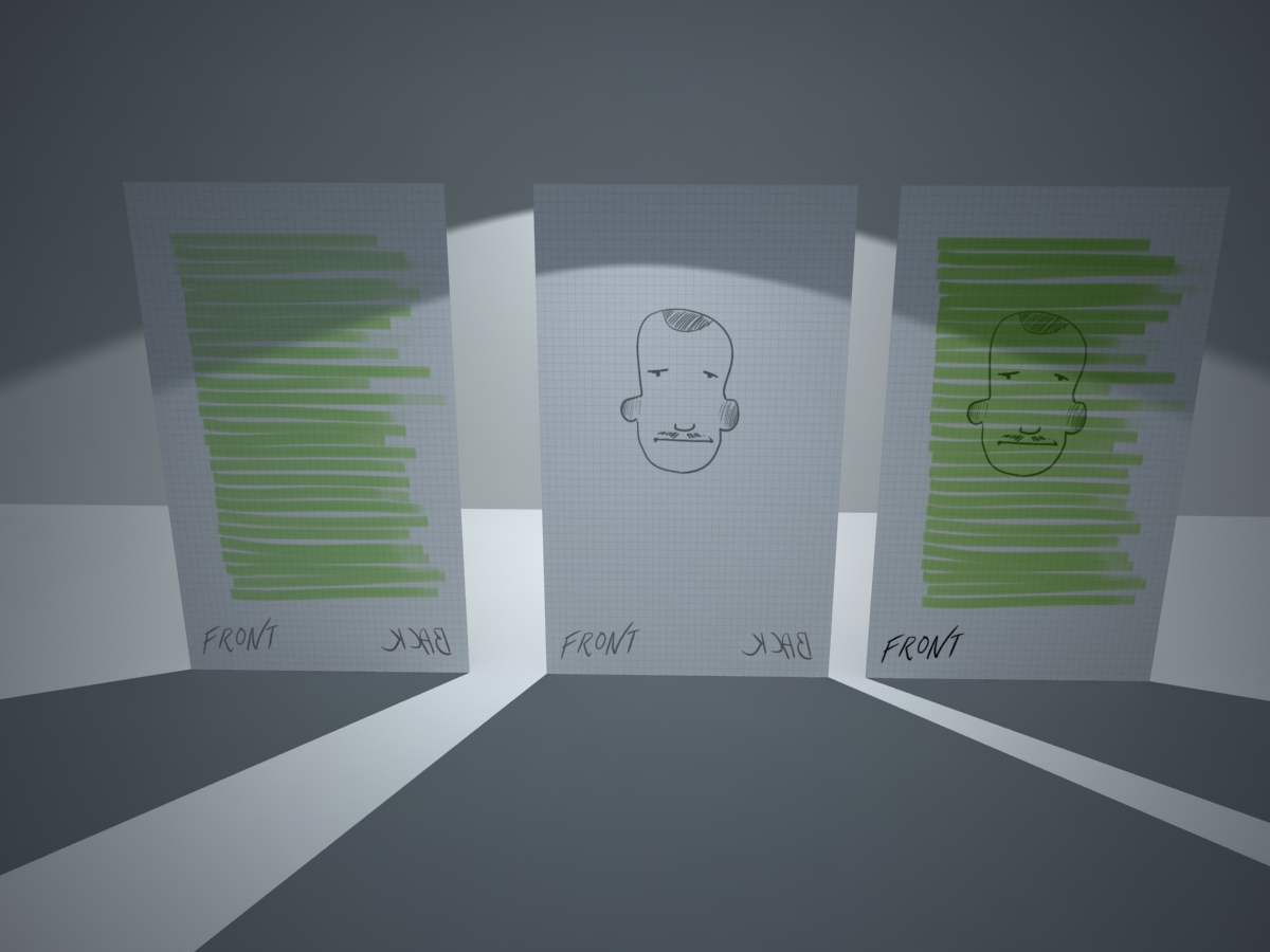

Turning the problem around, and instead tring to recreate what's in the photo using other techniques, I've tried a few solutions. One, which... almost succeeds, is shelling the object and using different 2sided materials (with the same back and front materials) on the different sides. It kind of works, but the backlit image is blurred and dimmed significantly, and the render takes a bit longer. This really isn't very useful. Image below.
Using the 2sided material without the extra back material
This is easily the best way to use the 2sided material - as long as you keep the translucency fairly low. In the renders below the translucency is first set to 96RGB and in the second image set to 255. The first render looks ok, but in the second one the papers laying on the table go almost completely black. I guess the only conclusion you can make of this is that you will have to keep translucency very low when working with materials like paper, or you will get unnaturalistic renders. This also removes the option of having two different sides of the material, unfortunately. Images below.
