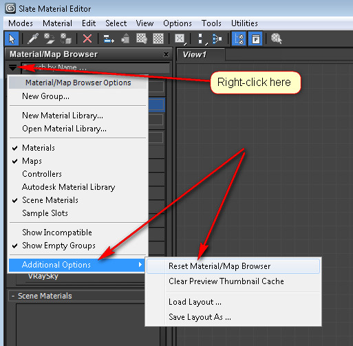

        I assume you are using the Slate Editor: are you actually looking in Maps > Standard? Or are you looking in Maps > VRay Adv.? Because the two maps you mentioned are both in the rollout Maps > Standard.
        If they really aren't there, and since they ARE in fact loaded as plugins, you might consider resetting the material/map browser. See below:
          Believe it or not what was happening was that when I was in slate and looked under 'Standard' the bottom of the list was cut off by my screen with no scrolling option. Weird it doesn't come up. I had wondered if that was happening last night and tried searching for it in the slate material\map browser but the search didn't come up with anything which is kinda weird too. When I just browsed for it I found it.
