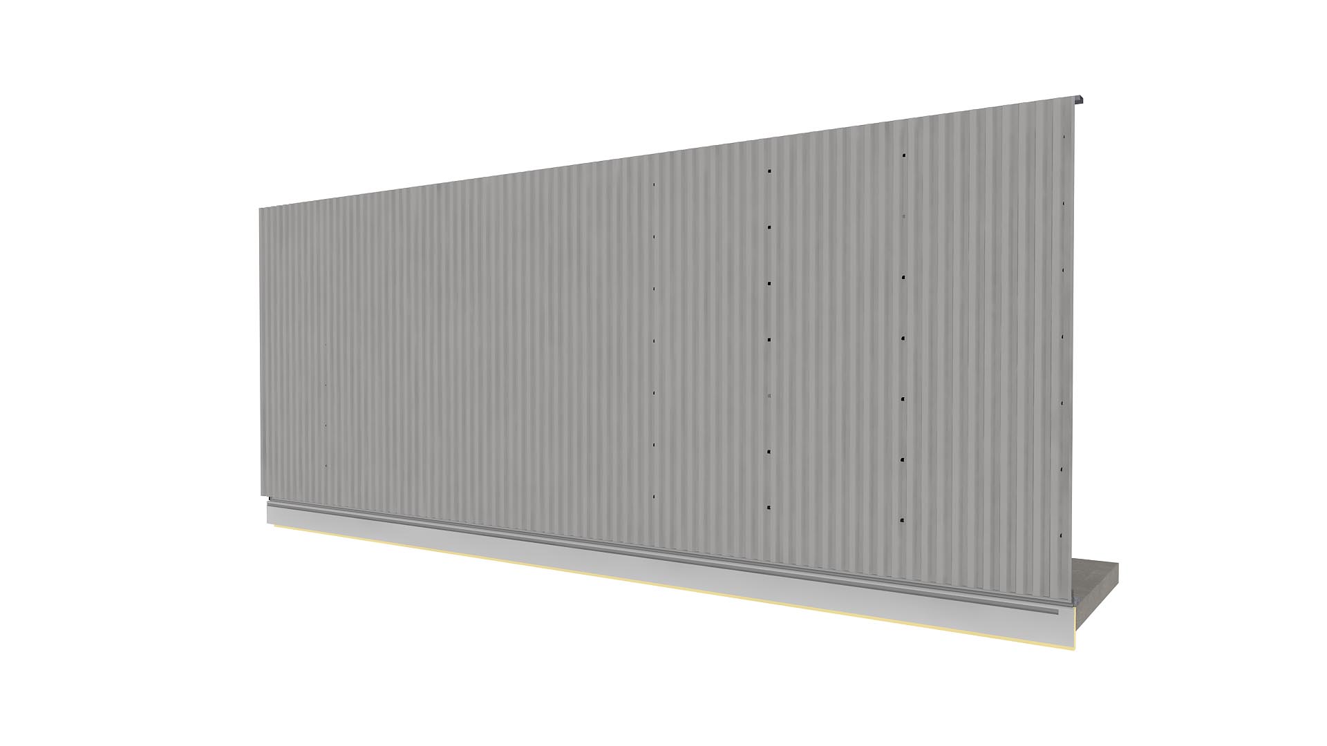

here's 2 shots to show the issue.
The first shows the major problem of blotchy spots across the panel. The second shows how this issue goes away as the camera moves to the opposite end of the panel. The second image shows too that there are some objects (screws in this case) that are rendering black.
When I render still frames across the entire length of the panel, I don't get any of these issues. I assume that it has to do with the IR prepass settings. I'm at a loss.

Use camera path option is not recommended for a large animations. Large animation are considered to be animations with a thousand frames and with a very long camera path - where you want to view every part of your project with a single camera. Using camera path is optimized to work well with small camera paths, for long animations (paths) you have to switch it off.
Camera path option always shoot samples from the entire camera path regardless whether you render a part of animation or the entire animation - so if you want to create a additional samples where you have a blotchy render - you have to turn this off and to calculate additional IM samples in these areas.
Having a blotchy result might be caused by poor IM quality - is it possible to send us your scene and a couple of rendered frames - we would like to see your settings.
