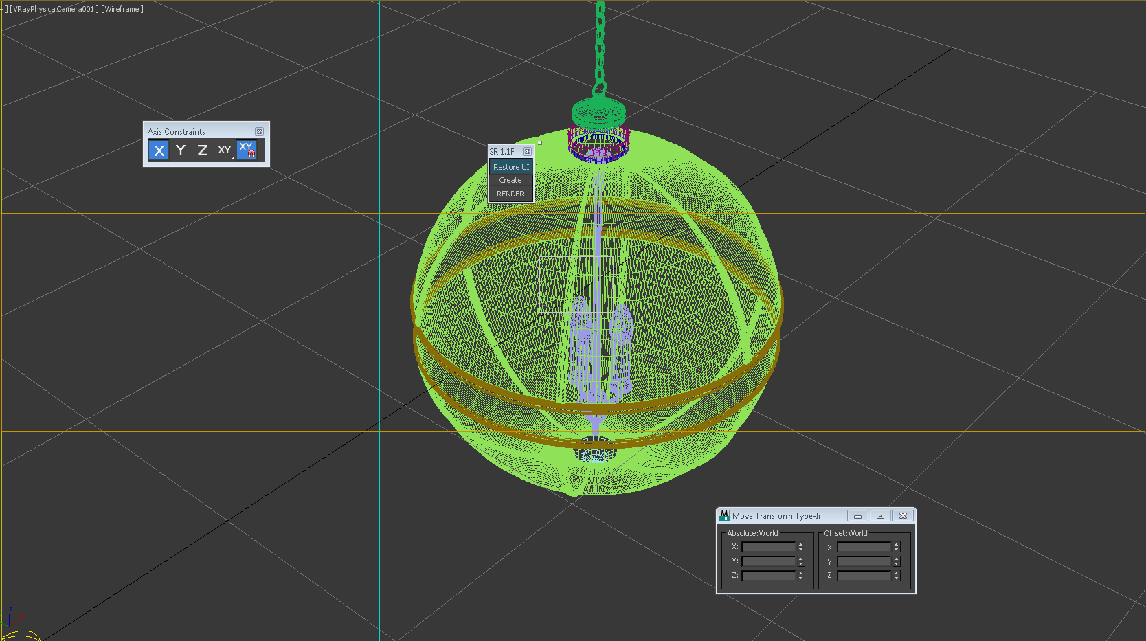

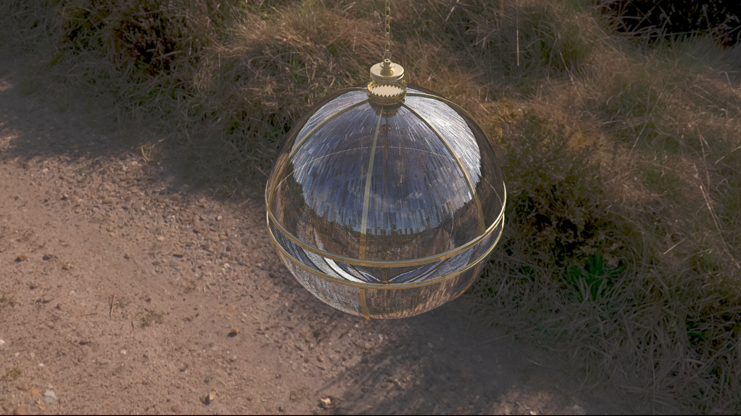

    I am modeling some light fixtures, but my glass isn't rendering nicely. I am getting black lines... is it the glass, or the HDRI? The geometry is clean and subdivided nicely.

    To me looks it looks like gemetry ovelapping try to use secondary ray bias Bobby.

      Looks like coplanar faces? Might be worth putting an stl check on it to see if anything shows up? either that or turn up the vray ray bias in the global settings to remove the issue - if going to a value more than 1 fixes the issue it's likely double faces. Is it welded properly? Where did the mesh come from?
        I guess it was co-planar geometry. I modeled it, and simply used a sphere, deleted the inside, and gave it a shell modifier. I deleted it, and just added a sphere, and all is good. I needed the sphere to create the frame.
