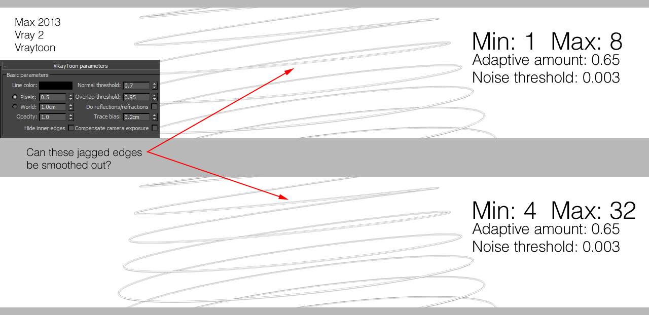

    Silly question but i'm not having much luck increasing the aa of vray toon. Am I mistaken that the sampling should go along for the ride with the image sampling?

    At half a pixel wide, they probably cant be smoothed any more. You could try doing it 2x the size at 1px if you're rendering a pass to use in post.
      Yep Ive been rendering it at 4k and sown sampling. It works fine but offends the sensibilities

        Use a different AA filter with larger size - f.e. Soften or Video.
