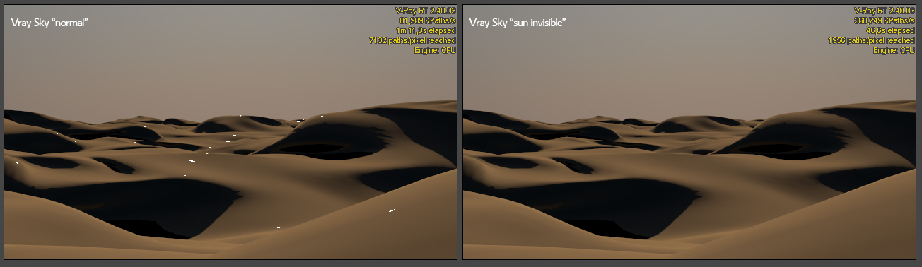

    Hello there,
    i have some white dots while using a reflection map and using Vray Sky.
    if i set sun to invisible at Vray sky, i dont get this. and speed is quite different...
    some kind of bug?
    Hello Mario,
    The result you got with the white spots is normal.
    Vray Sun is a very bright lights source - and highly reflective materials will reflect it with such very bright hot-spots.
    You can remove them by turning of Sun's visibility like you did.
