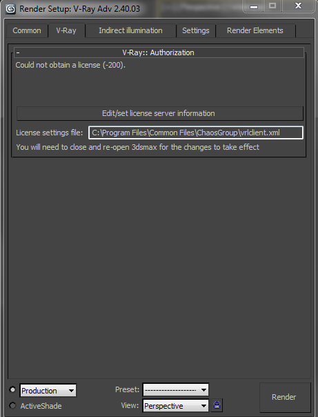

    Hi,
    All of a sudden I am getting this error.
    Thanks Regards savio alvares
    Can you check if your license server is running and if you can open the license server web page?
    Vlado
      hI Valdo,
      I uninstalled vray and the wibukey setup from the sys.
      after reinstalling both vray started working.
      Thanks Valdo
        Ok then, good to know.
        Vlado
          probably rebooting the lic server is all you need to do.
