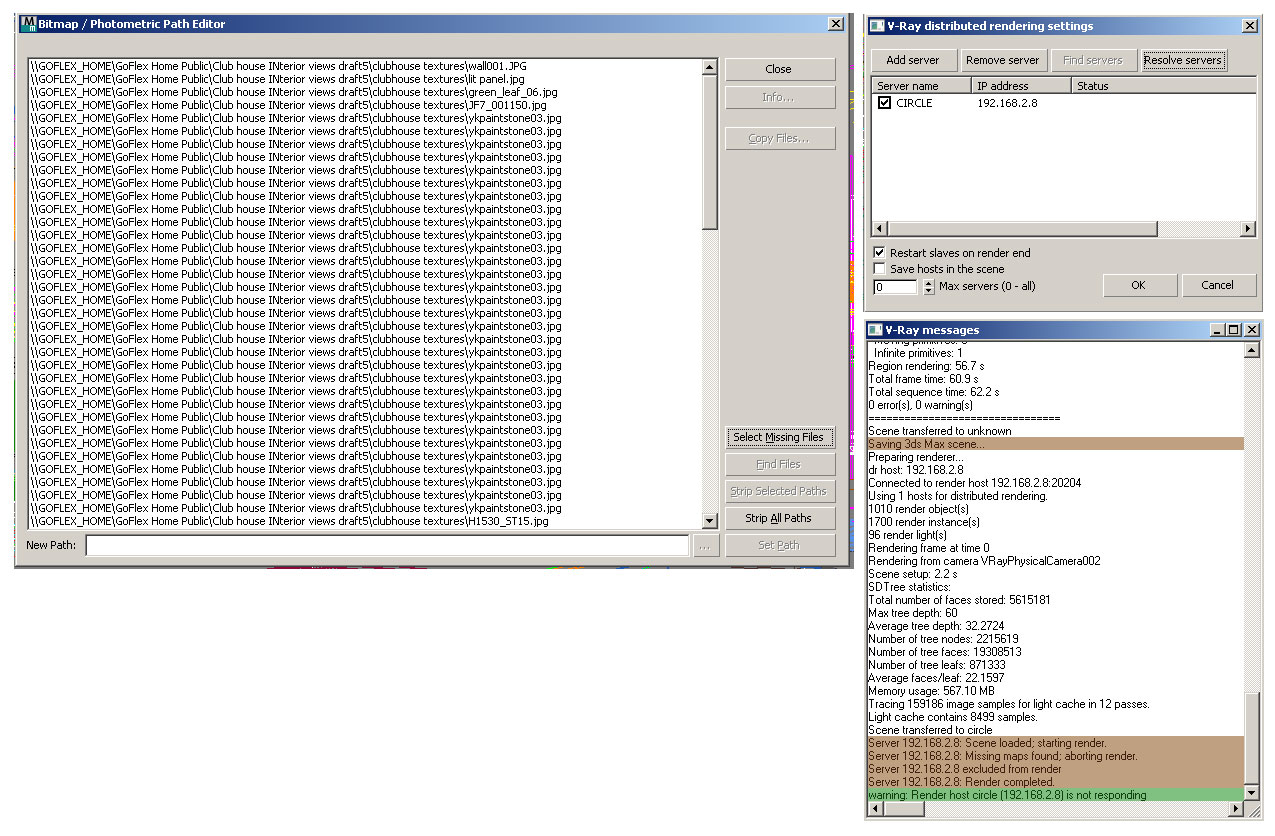

ID:	847266Till morning, DR was rendering ok except that other computer(slave) was rendering with no materials. I changed path to UNC ( see attached jpeg) I also enabled Check for missing files option. Now i am getting error as in "v-ray message" screen ( see attached) & only main main machine rendering entire image. I am manually starting the spawner.

                  Step by step-
                  - To centralized resources i brought Nas drive ( Seagate goflex). I transferred all data to Nas drive.
                  - I made archive of one of my current project to collect all textures. after collecting all textures in one folder i put this folder on Nas drive
                  - I opened max file & stripped all paths & have set new path of the folder on Nas drive.
                  - Disconnected old drive from where textures were picked up originally so that it doesnt pickup texture.
                  - No success on rendering
                  I dont think there is any networking issue as i am able to do DR successfully for new projects where i am assigning textured directly from NAS drive. But somehow i am just not able to render my ongoing projects with the above procedures... Dont know where i am wrong..

                    If you are setting your map paths with the Bitmap/Photometric editor. That may be the problem. I've had problems with that in the past and have since gone a different direction. When opening an older project, I use Colin's Script, Relink Bitmap, or Asset Tracking.
                    Also make sure that you don't have any extra paths to textures included in the Configure User Paths area, under the External Files tab. Any paths in there are only local to the user computer and don't work on the rendernodes. So your computer may not give you an error, but if the rendernode doesn't have that exact path setup also, it will not be able to find the maps.
                    There is a map some where in your file that the rendernode can't find.
