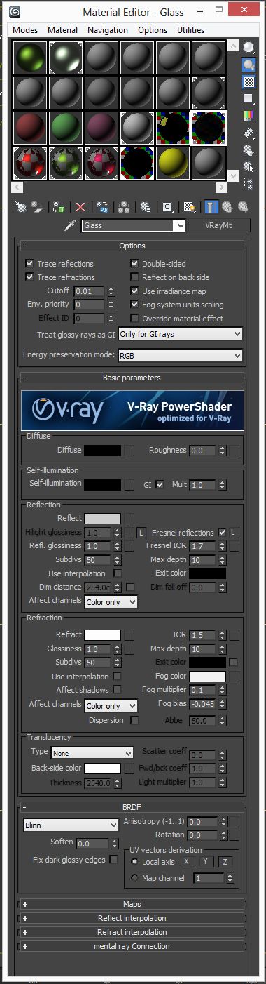

    Hi Guys,
    I have tried every setting possible to stop this weird rendering problem. Its the starting of a lemon twist. I have poly modelled it and applied a Turbosmooth to it, but it looks like the liquid is un-doing the turbosmooth modifier. The Lemon twist is not rendering smooth?
    Any Ideas? You can see the effect I need on the twist with the liquid removed render.
ID:	877491Click image for larger version

    So if I set Glossy Refractions to 1.0 the problem goes away. If a set it back to 0.85 which is the effect I want it comes back? Use Refraction interpolation settings on max does nothing either. Makes it bit more blurry but the problem is still there.
    Daniel
    www.danieljhatton.com
      Solved. 'Use Irradiance Map' was ticked in all of the materials.
