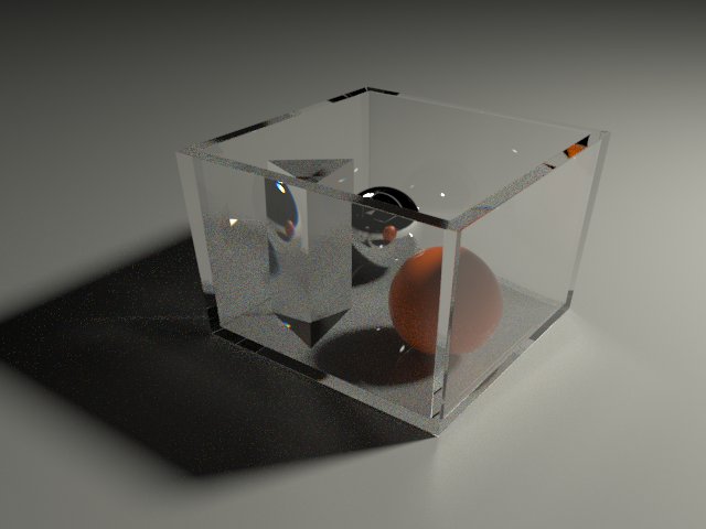

        Ive sent a link to the sample file. Im thinking the dispersion bug is possibly related to the more general BDPT refraction issue that I'm seeing.
        Here is the scene with a standard glass setup (black in the diffuse) using the PPTracer. The results are as I would expect.

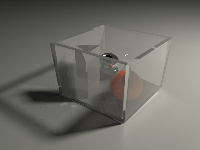

        Here is the same file rendered with the BDPT

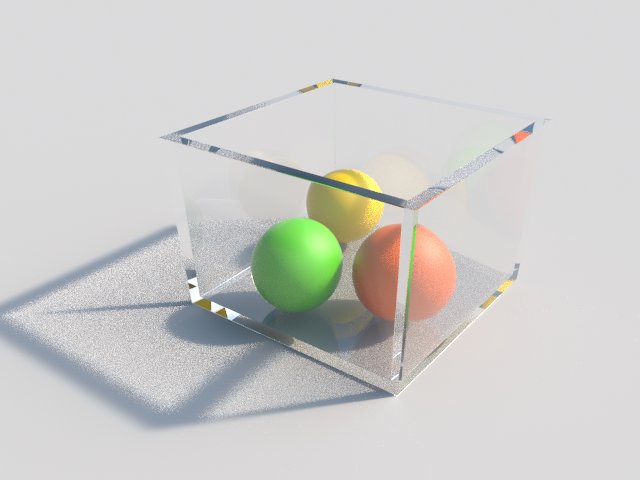

            As promised here are some test using the various rendering methods with dispersion. I have little doubt that the issues are related but it may help to see some of the combinations.
            Here is a brute force test using a HDR in the dome light with dispersion off. This is as I would expect, transparency in the right places and appropriate shadows. noisy but about the best you can expect.
