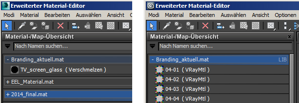

          some screenshot of the library saved with 2013. as you can see 2014 open only one of the around 40 in there.

            Have you made sure that "Incompatible" materials are visible in the library? If your renderer is anything other than vray that might explain why they're not visible.

              we only use vray here.
              BUT - this only happens if i start max 2014 with new szene - than i can't load some mat-lib in correct way.
              if i open some project, than i can load any mat-lib and it shows up fine.

                Right but have you checked that your default renderer is Vray? Because if it's MR then when you open a new fresh scene the issue I've described might happen. This would explain why the materials are visible if you open an existing Vray scene.

                  that's it!

                    I thought that would be it! Glad you sorted it... it's a nice timesaver if you set Vray to default renderer and use your most common settings. saves a lot of time for most new scenes.
