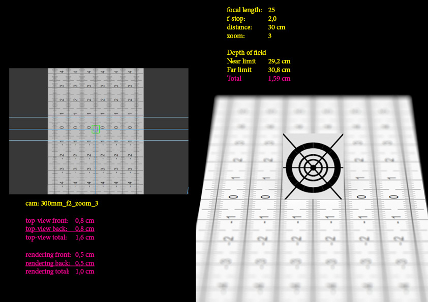

                  well, lets go: focus-test for VrayPhysicalCamera!
                  for calculation i used a Canon 5D MarkII, crop-ones turn out almost same result, but why to use here
                  i renderd in 2400 pixel width. for exact measuring limits, you may render in bigger resolution but for now it should be enough.
                  as i supposed, everything fine with zoom = 1
                  top-view still perfect with zoom = 3, rendering turns out wrong
                  rendering is out of range with zoom = 6, front- and backfocus doesnt turn out clear anymore, but near and far limit of cam is still correct!

                      Hi,
                      I'm Veselin Georgiev, one of the developers from Chaos Group.
                      Your observations that the near and far limits of the camera do not correspond exactly to the places where visible blurriness sets in are correct. However, just deciding on what is blurry is a complex matter and cannot be decided in a discrete - "this is blurry and this isn't" - way. Perception of blurriness encompasses a whole lot of other parameters: including the geometrical complexity, the image sampler being used, the number of DOF subdivisions, DOF shape, what type of monitor are you using to view the pictures, its PPI, the conditions of your eyes, image brightness and so forth. Capturing all this in a simple pair of camera front-back focus planes is impossible!
                      It can also be argued that the visual determination of where the blurriness sets in is purely subjective.
                      One of the things is that, on the zoom=6 render, you assess the back focus to be shorter than the front-focus interval, which is geometrically impossible. The front focus interval is always shorter, and if it seems it isn't, that is just a perception thing. Or an optical illusion, if you will.
                      Also, given that the distances between the camera and the target are different in the three renders, and thus the perspective is different as well, the zoom > 1 renders have a longer interval where the blurriness gradually increases. Humans have the tendency to put the blurriness "threshold" earlier in that scenario.
                      All in all, if in the zoom > 1 scenarios the front-back planes seem to be misplaced, then they are probably just as bad in the zoom = 1 case, and by the same factor, but it's not that visible.
                      So anyways, as Tashko mentioned, the front-back planes exist only to give you a very approximate idea of the DOF. You have to experiment, more or less by trial and error, to find your best combination of focal length, f Number and proximity to the subject.
