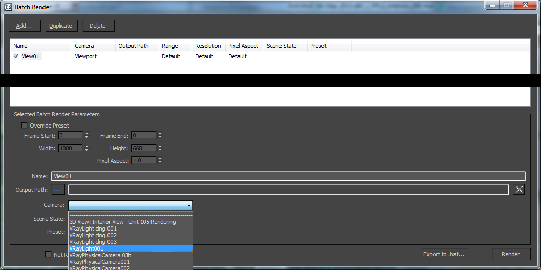

    (Almost) latest stable build (from 2013/07/13) seems to have an issue with BB.
    In job submission dialog, there is a pulldown list to select the camera.
    Now it also shows any v-ray lights as well as scene cameras and you may accidentally pick one.
    Then the job will fail reporting "AutoDesk 3dsMax 15.6 reported error: Camer VRayLight004 defined but not found."
    Obviously the job fails...Avoidable, but seems like new behavior?

    However, would it be possible to upload a screenshot of your BB submission settings?

        Being able to look through V-Ray lights was a feature requested by customers, so it's not going away. The fact that backburner fails is a different matter. Does it fail for standard lights (direct/spot)?
        Vlado
          Feature is nice IMO. Just checking to see if I was imagining this, it's not a real issue as long as I don't accidentally pick a light.
          Have not tried this with picking a standard light, but was assuming it would fail, too. Thanks.
            Hi,
            I got the same error in BB with max directional light : Camera Direct001 defined but not found." with Max 2013.
            Tried the same with Max 2014 batch window and there was impossible to select neither V-Ray light nor the native Max light.
            Tashko Zashev | chaos.com
              Hi Tasho,
              Thanks for checking; It is apparently a Max2013/BB problem...
