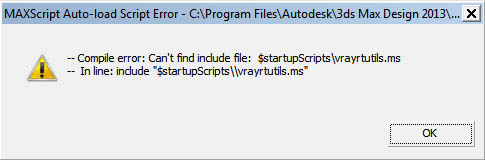

    Just installed Vax 2014 and vray_adv_24004_max2014_x64. Now when I open Max 2013 I get a Compile error: Can't find include file: $startupScripts\vraytutils.ms. Is this something to be concerned about?

          My computer started to give me the same errors one week ago. My coworker started yesterday having the same message. The the version is 2.40.03 and was installed quite a couple months ago on 3dsMax 2013. No software/hardware changes from any part. As mentioned, it still works, but just weird that it pop up like this on our machines.

            Hi there,
            @3ddesign and @thablanch, Can You please paste the whole error message and the likes of it from the MaxScript listener it should look something like this, with the respective file names at your side:
            -- Error occurred during fileIn in #C:\Program Files\Autodesk\3ds Max 2013\scripts\startup\vrayinstall.ms; line number: 8
            >> MAXScript Auto-load Script Error - C:\Program Files\Autodesk\3ds Max 2013\scripts\startup\vrayinstall.ms Exception:
            -- Compile error: Can't find include file: $startupScripts\vrayutils.ms
            -- In line: include "$startupScripts\\vrayutils.ms" <<
            Alexander
            Alexander Kazandzhiev
            V-Ray for 3ds Max developer
Name:	Error Message.jpg
              -- Error occurred during fileIn in #C:\Program Files\Autodesk\3ds Max Design 2013\scripts\startup\vrayinstall.ms; line number: 9
              >> MAXScript Auto-load Script Error - C:\Program Files\Autodesk\3ds Max Design 2013\scripts\startup\vrayinstall.ms Exception:
              -- Compile error: Can't find include file: $startupScripts\vrayrtutils.ms
              -- In line: include "$startupScripts\\vrayrtutils.ms" <<
                Seems like You are left with an even older version of vrayinstall.ms. You can just delete this file C:\Program Files\Autodesk\3ds Max Design 2013\scripts\startup\vrayinstall.ms, it just registers V-Ray items on the main menu bar of 3ds Max. If You miss them You can execute updateVRayMenus() in the MaxScript listener.
