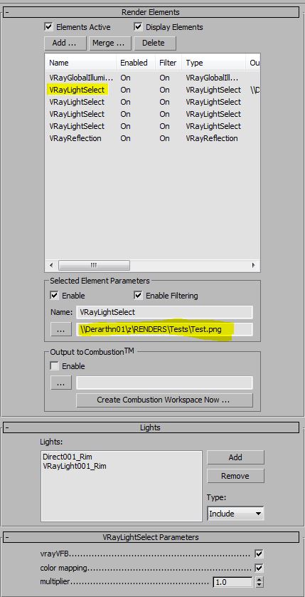

      I checked the frame buffers on the rendernodes and the lights are on they are just not saving out. It's very weird because it's only the 1st lightselect element out of the 4 but if I have it on it's own it works fine or if I render on my PC there's no problems.

      EDIT: would it make a difference if I'm using the max FB? Not currently using the VFB.

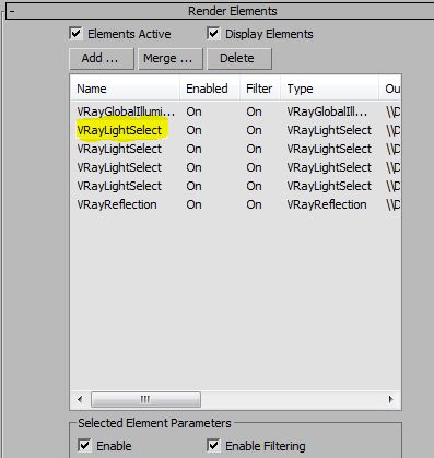

          I'm saving them from the render elements tab, under Selected Element Parameters, I think that's what you were asking?
          And then I'm saving them as PNG images.

          These are my render elements settings...

            Hi again,
            I made few tests and it seems that the problem is in the render element naming. Could you try to rename each Lightselect pass to have identical/unique name?
            Please let me know if this helps.

              Hi Tashko,
              Thanks again for your reply. I did the test and renaming the element to a unique name worked. Strange that it worked for the other 3, just not the 1st one.

                Thank you.
                I spoke with the developers about this and the only option is to change the name manually for now. Every render element needs a unique name in order to be saved correctly.
                Probably we will add an automatic renaming at some stage.
