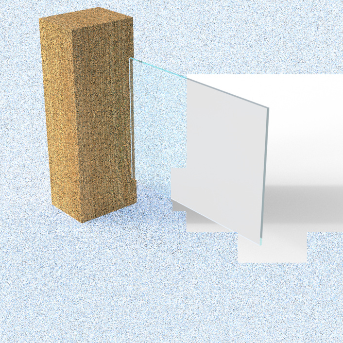

    What happens is that I can't get the shadows of other objects to show up in the alpha channel (on the surface where I use the vraymtlwrapper) when the shadow is behind an object with glassmaterial applied. It works in rgb but not in the alpha.

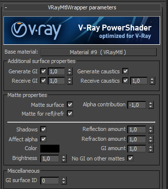

    I use VRayMtlWrapper with the following boxes checked: Matte surface, Matte for refl/refr, Shadows and Affect alpha. I have set Alpha contr. to "-1".

    Which is the exact version of Vray 3.0 that you are using ?
    It works on my side when Affect All Channels is activated for the Refraction Layer of the transparent object.
    For some reason matte-objects is visible in the refractions (alpha is OK) but this won't be an issue. Since Affect All Channels option is activated I won't need refraction render element in compositing stage - all needed information would be distributed over other render elements like GI , Lighting , etc.

    And here is a simple compositing and background-change in Nuke:

      Suddenly I could not reproduce my error and started looking at the settings for the glassmaterial. It seems the problem was that I for some reason had chosen All channels in the Affect channels rollout in the reflection settings. When selecting "Color only" it works like a charm.
