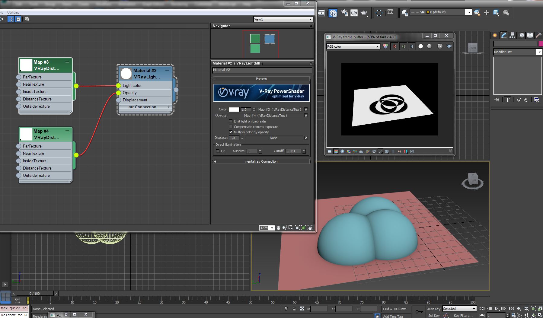

    Hi,
    Can you try this setup:
    It would be better in this case to add V-ray light mtl in order to avoid this flickering.
