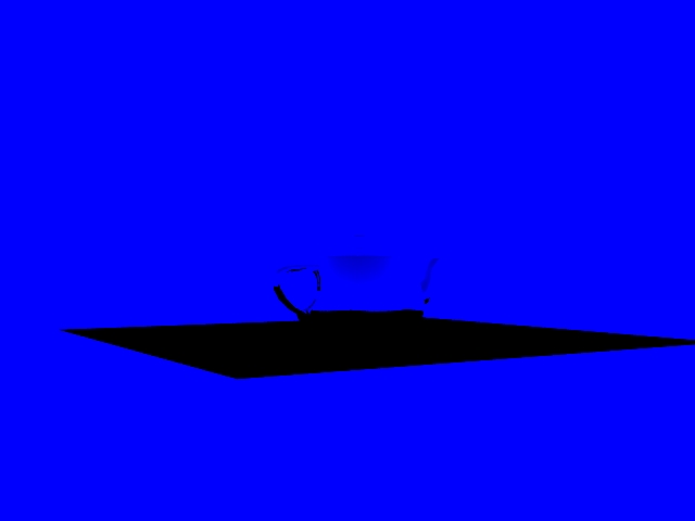

    so im tyring to do a time lapse sequence (day night/day night) i have a VraySun linked to a circle, that orbits in a full 360, so i get a proper "24 hour" period.
    when used with the VraySky and the sun goes into a negative/southern/far below the horizon space, insane blue values appear. any fix for that other than making sure your sun doesnt go too far down below the horizon?

    more of the BLUE values

      The VRaySky only works for "day" time as it is linked to the sun
      When the sun goes behind earth in lamens terms the stars and moon comes out. The VRaySky does not have functionality for this so I would recommend to cheat things when your sun's Z value goes below 0
      Improvements in the sun/sky system has been asked many times in the past. You'll have to cheat stuff until then

        yeah, thats a pity. i get that it only works for a "daytime" system and doesnt have a "star/nightime" system implemented... but i sure wish the VraySky didnt get insane blue values as the sun goes negative.
        im sure the math involved in getting the Sky to react to the Sun is complex, but is it not doable for the sky to turn "off" when the sun goes too far south to avoid the blue blowout? vlado?

          i've keyframed the values to drop it to black just as the sun hits the horizon, rendered with a dusk hdri with some overlap either side and rendered with a night sky hdri with some overlap then faded between the 3 in post. if you keep the fade moving continuously you cant tell.
            AH! thats a great idea. thanks! im gonna try some fancy expression so that the "Sun intensity multiplier" in the VraySky goes to zero as soon as the position of the sun hits a certain negative z value.

              Will definitely need to think of something; however we can't just make abrupt change to black, it needs to be sort of gradual...
