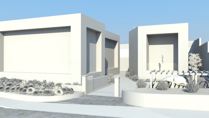

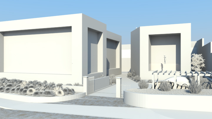

    Can you post a few frames or crops of frames? It might be that the flickering is due to low AA samples rather than GI.
    Vlado
ID:	851626Click image for larger version
ID:	851627Click image for larger version
ID:	851628Click image for larger version
ID:	851629Click image for larger version
