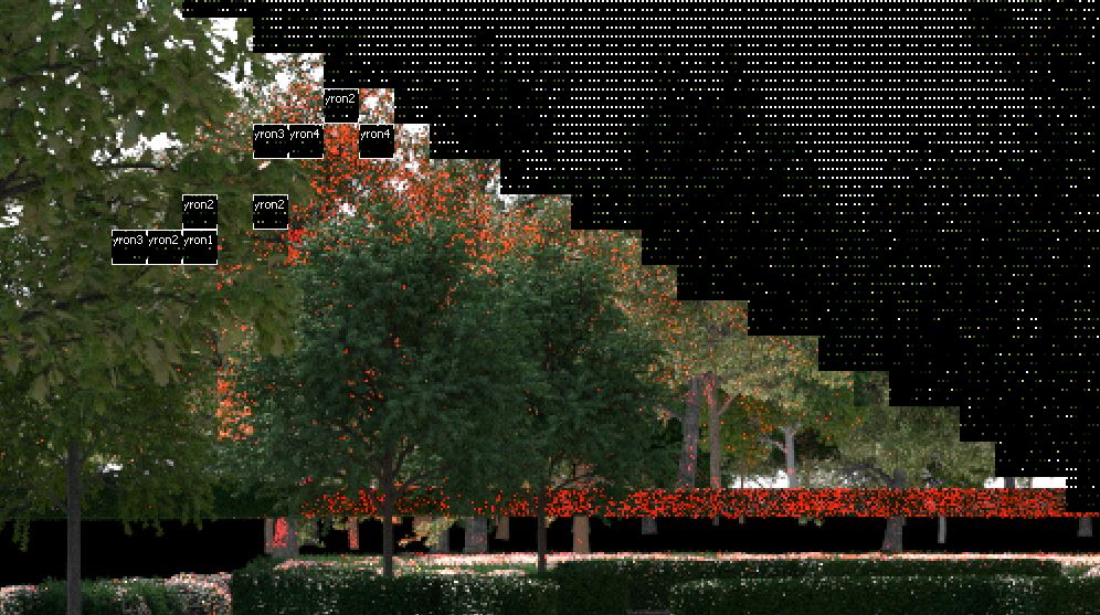

    Getting these red speckles, no idea where they are coming from. Its caused by some material, as with an override they are gone. But Ive been through the materials and they are all pretty normal.
    Also if I turn off GI it disappears. (BF + LC)
    Any one come across this?

    Do you get any warnings in the V-Ray log? Also, which V-Ray version is this?

      No errors (that Ive seen)
      2.40.04
        Probably an Autodesk Material. Use a converter to find it maybe.
        Alex York
        Founder of Atelier York - Bespoke Architectural Visualisation
        www.atelieryork.co.uk
          Will take a look, had already tried but may have imported some rogue objects since.
            check that the plants aren't using a map which has its rgb output set higher than 1.0

              VMC might help with this.
              Also, turn on material previews in your mat browser and look for anything red.

                ok, its gone for now. no idea what it was.
                Couldnt find any suspect materials, but probably was a dodgy mat somewhere.
