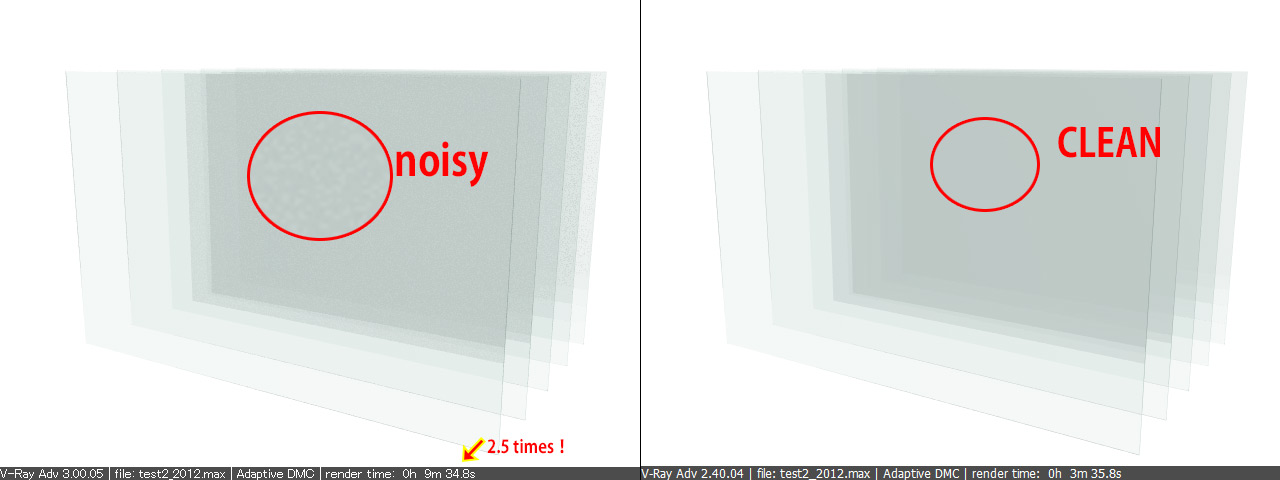

    V-Ray 3.0 is noisy when this scene is compared with 2.4.
    Where is wrong?

    There is nothing wrong; after a certain reflection/refraction depth (5, I think), V-Ray 3.0 will switch to probabilistically choosing reflections or refractions to save render time. If you add more AA samples, the noise will go away.

        A question is asked again.
        V-Ray 3.0 is faster than 2.4.
        But the rendering of this scene cannot be done in shorter time in the same quality as 2.4.
        V-Ray3.0 has many noises and its a rendering is long.
        There is no worth using V-Ray3.0.
        Is there any solution?

          Well, for this particular scene, it is what it is. It is very easy for me to revert back to the old behavior, however this is an isolated test; in a real scene, it is very likely that there are many more things going on and more image samples will be needed anyways for various other effects. V-Ray 3.0 has an advantage in that case. If one scene out of 10 renders slower, I still think it is worth it. To conclude from this one test that V-Ray 3.0 is worthless would be wrong.
