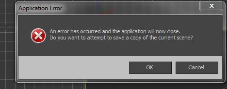

            When I try 3DS Max 2013 get this error:
            However, I've resaved the file in 2014 to version 2013 and the proxy conversion works fine then.
            Update: can't open on the second machine as well.
