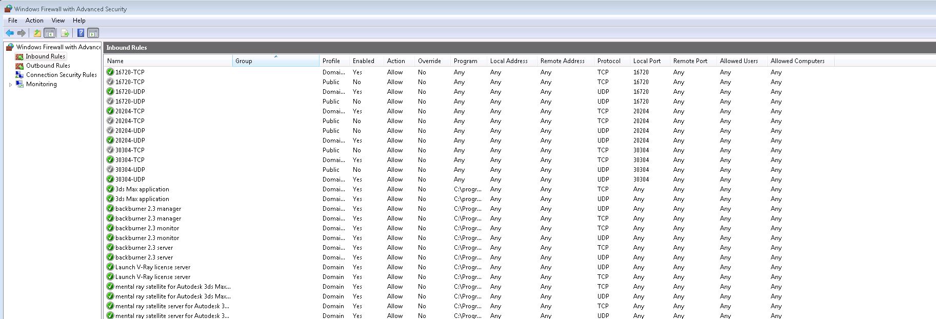

    So from here you need to get your IT guy to exempt your machines from any such policy updates (if that is operating) or just get them to create Ingoing and outgoing firewall rules like the ones shown here
    Go start menu, type "firewall", go to the advanced link on the LHS and change the ingoing and outgoing rules
    Vray 2.4 32bit - used to use the port 30304 to communicate
    Vray 3.0 now uses 64bit port 20204
    Make sure these are allowed in both the incoming an outgoing connections on the render farm node
