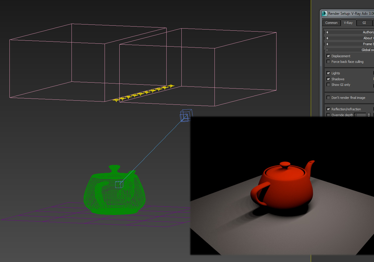

    This has really bugged me. Whenever I add more light (vraylights, vrayies lights), the more noisier the rendering.
    So I've done a simple test
    1. Scene 1 -> create a new scene, render a simple teapot with a single vraylight (default setting). No camera, everything in default vray setting (no GI, reinhard gamma 2.2, adaptive AA) -> rendered ok
    2. Scene 2 -> added an enclosed box away from the teapot, away from the view, and put additional 50 vraylights INSIDE the box -> the teapot rendering look more noisy, even though the additional vraylights should have no effect on the teapot (they're enclosed in the box, and not visible from the view)
    3. Scene 3 -> put 500 vraylights in the box -> rendering look terrible
    is this a bug? or maybe i misses something? as far as i know it didn't happen when i was using vray 1.5 (i skipped directly to vray 3)
    Vray 3.00.07, max 2014
    max file is attached
