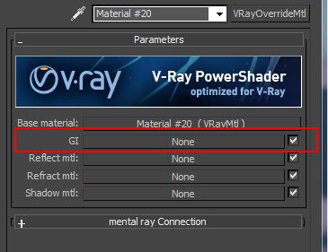

      4.By using brighter material into GI-override material:
Name:	2014-06-30 15_32_13.png
      Feel free to send us a part of that scene for investigation if you still have difficulties to set it up.
