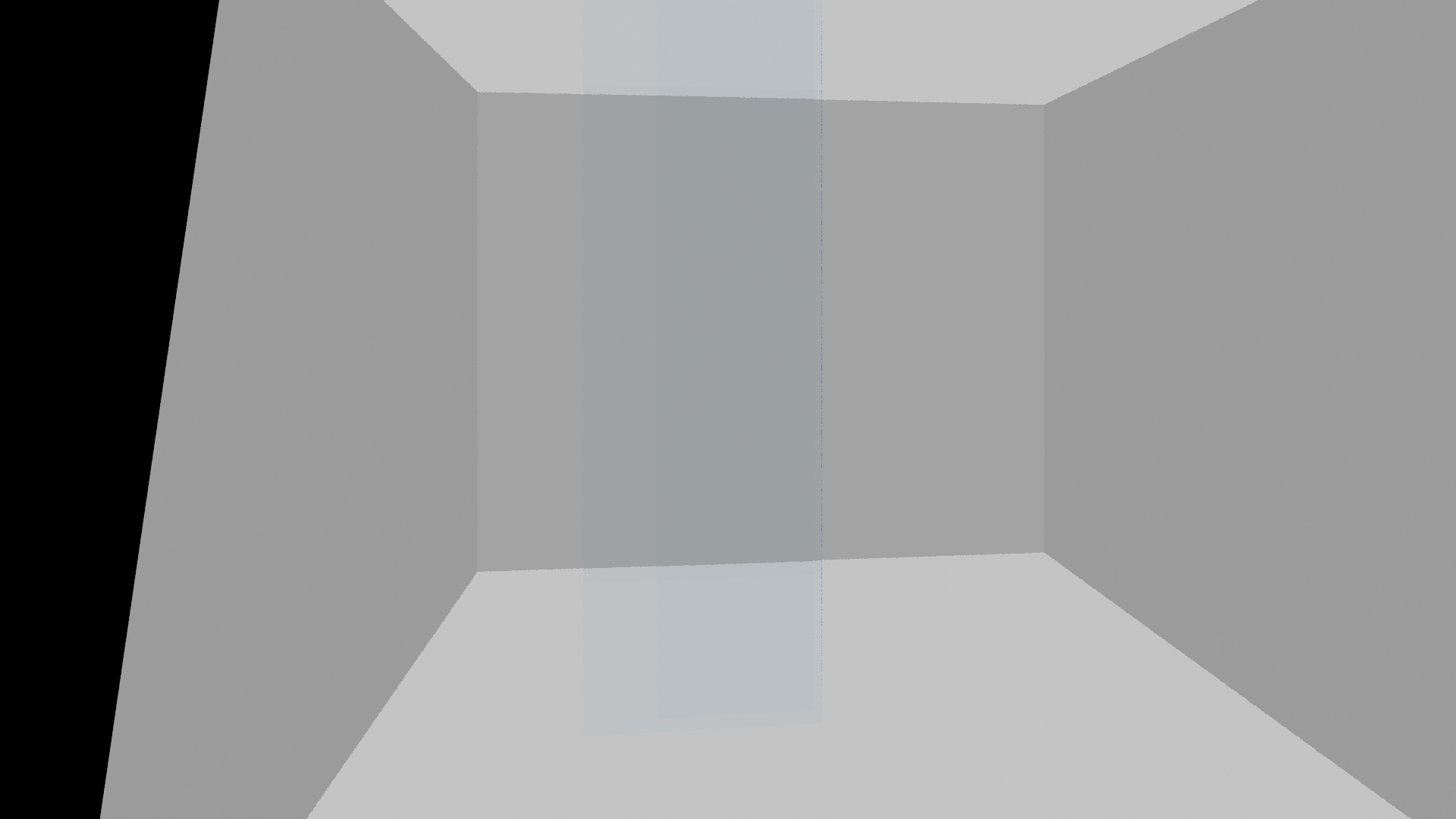

    Recently finished a job on which I struggled a lot with this particular problem. Double glazed partitions everywhere. (hello massive rendertimes)
    Whenever a few panes of glass stacked up I started to get areas of noise that permeated every single pass.

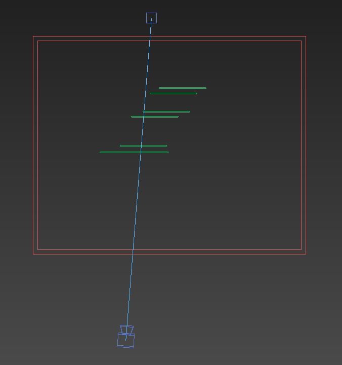

    Since I cant post anything from that job, ive recreated a simple scene which shows what I mean.
    Note that there are no lights or GI in the scene, as when troubleshooting the main file I found that the noise was exactly the same with or without GI and with or without lights.
    What is this noise and how do you get rid of it?
    you can see 2 panes are fine. but beyond that is bad. AA is lowered to exaggerate the effect.
    I tried all spinners and cutoffs I can think of
    Any ideas?
    This is built into V-Ray 3.0 right now - beyond a certain ray depth, it will choose randomly between reflections and refractions. This reduces render times, but introduces some noise. More AA subdivs generally reduce the effect.
    For the next service pack I've added a bit more logic to this, so that the random choice only occurs for reflections/refractions that do not contribute too much to the image, so it should be a lot better.
    Vlado
      I see, good to understand whats going on. But this requires (or did on my scene) a lot of AA to clean up, on top of the stacked refractions and reflections I was getting some pretty horrific render times.
