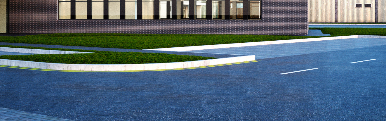

    I have looked high and low for a solution to this problem, and whilst I've found many, many topics with people suffering the same affliction I've yet to find an answer...
    From what I can tell, the problem only occurs when a texture is involved; anything using just a colour, or noise map etc seems to render just fine. The problem looks like some kind of gamma disparity between the workstation and nodes, though whether this is the case I don't know. I appreciate that the problem is subtle, but sometimes it is worse, sometimes not...
    Just as a side note, the "darker" looking buckets are the ones rendered by the local workstation, and the lighter (incorrect?) ones are the nodes.

    I've seen loads of topics on this, so has anybody worked out what it is or how to fix it?
    All our workstations are on max 2014 and the latest VRay build, as are the nodes.

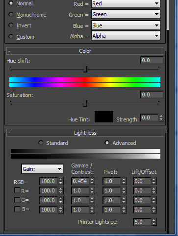

                    Hello, I had the same problem too, inexplicably, only few render nodes rendered darker buckets from the same bitmap (grid and ground)
                    I thought there was some plugin missing and comparing them it turned out to be the same on every pc, same version of sp5 3ds max 2014, vray 3:00:08 ...
                    and I solved in this way:
                    - I changed the range of textures that gave problems to 1.0 (instead of recommended)
                    - I then applied a color correction map to which I have assigned range 0.454
                    now buckets are fine and same brightness across the frame
                    Hope that could help someone and feel free to let me know if you solved as well this way
