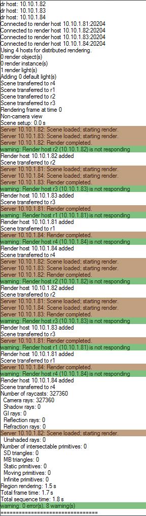

                            1) my company have 4 render node in our server room, we never shut down this.
                            2) the V-Ray License is install on my pc, i always shut down this pc everyday after work, when get back to work the next day, i always need to log in and restart all the Vrayspawner.
                            3) Today morning after i read your instruction about "Restart Servers On Render End", i try not to log in to restart Vrayspawner and just simply click render with a blank 3ds max file using Distributed Rendering, ofcause i get the following message in vray-log file, see attached:
                            and then i turn on the "Restart Servers On Render End" it not work at first time, but everything back to normal on the second click. [Problem Solved]
                            svetlozar.draganov, thank you evey much with your patience help and once again sorry about my english. now only the VFB reset level not solve yet. cheers~

                              Glad to hear that the issue is solved. Feel free to contact us if it happens again.
                              Regarding the other issue - it will be resolved once the latest Nightly build is installed.
                              It would be a good idea to install the license server and the hardware key(the dongle) on one of the machines which are never shut down.
                              With "Restart Slaves on Render End" you have to run at least one test DR job in order to restart the Spawners on the slave machines and then they will join the subsequent jobs.
