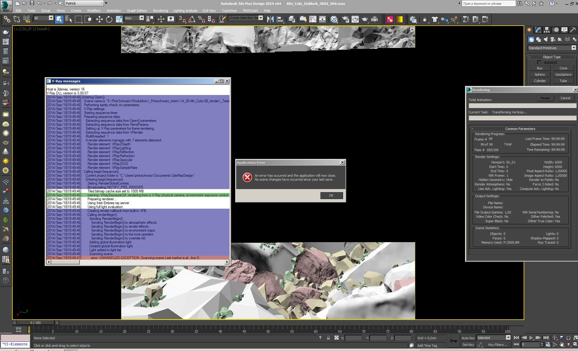

    Hi,
    I got a rather annoying problem here.
    This scene worked more or less fine for several weeks, then more and more crashes started to occur. Tried it on different 3 PCs (similarish hardware, all intel CPUs, NVIDIA GPUs, one most recent driver, other two older drivers), same result.
    The scene crashes approximately 75% of times when you hit the render button with an unhandled exception.
    It's a fairly simple scene, several hundred VRayProxies manually placed around in the scene, and two smallish multiscatter systems. Apart form that fairly small modifier stacks (<7) on some 10 or so objects. Nothing fancy. It is very polygon-heavy (>50 million) when rendering, but since the awesome VRayProxies do their job pretty good usually the scene stays at around 10-12GB at render time on 6k
    It's annoying since I cant really work with the scene and I am in the final stages of testing highres renders and tweaking shaders and rendersettings.
    I am also not 100% sure if this is a VRay or Max issue since when I got unhandled exceptions in the past they didn't crash max but only VRay.

    If I get an E-Mail adress, I can mail you support guys an ftp link containing the screenshot of the error aswell as the zipped scene file with all assets (~1.1GB).
    Also, this scene is also the one in which this issue is happening.

          Hi,
          We have already replied on your ticket with details about crash and how you can fix it.
          To help any other users that may experience this issue, it turned out that the crash was due to a specific arrangements of modifiers.
Name:	2014-09-25 09_20_17.jpg
          Most probably it is a bug in 3DS Max 2014, which is already fixed in the latest version and Extension packs.
          Tashko Zashev | chaos.com
            Thank you very much! I am hesitant to upgrade the SP on max though since I heard several reports of f****-ups after SP3. Never touch a running system. And I think I can live with collapsing stuff for now. Thanks for solving this issue!
