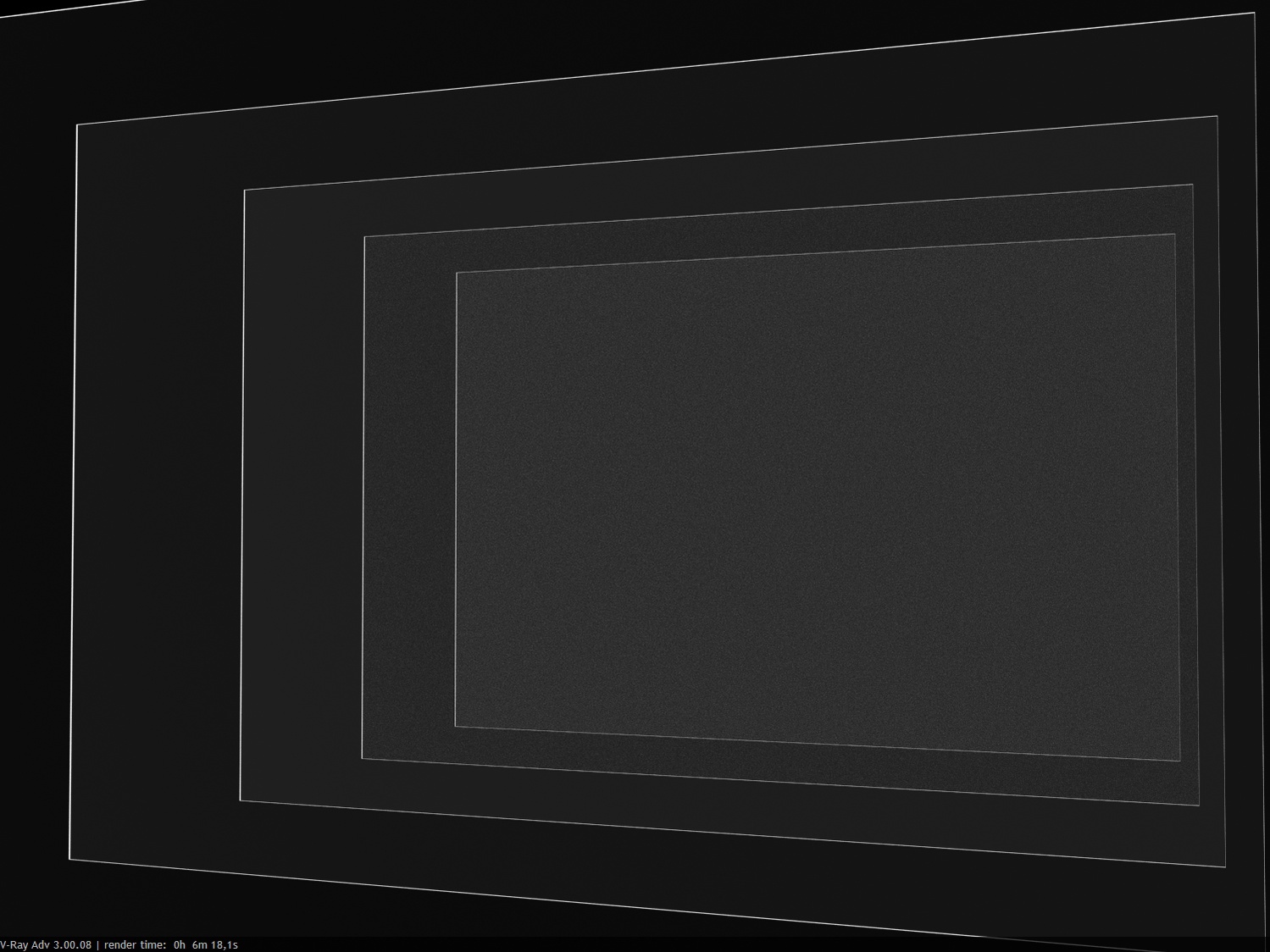

    I´m having serious problems using Vray 3.0. If i put more than 3 glass panels in any scene i get lots of noise impossible to remove and ridiculous render times. But if i render the exact same scene in Vray 2.3 y get clean and fast results.
    Scene info:
    New scene. All default.
    5 glass boxes (1cm).
    No GI
    Vray Sun+Sky 32subdiv (just in case)
    Material info:
    Black diffuse 100% reflect & Refract. Max depth 64 (just in case this was the problem)
    here is the images of the alpha channel where the noise it´s more visible.
ID:	880805Click image for larger version
    Someone can help me please?.

    Looks like it´s known issue. It´s there any solution?. I need to increase AA a lot just to clear some of the noise (not all of it) and this cause all mi setup render a lot slower.
