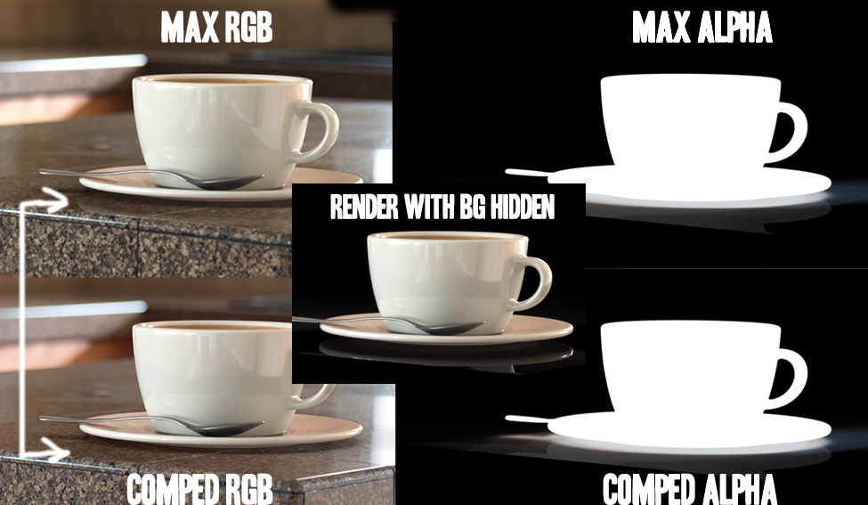

    Edit: Thought I had it, but I was wrong. My alpha doesn't seem to carry the reflections out of max. Example below:
Name:	Reflections Missing.jpg
    Where did the reflection go? It seems to be there when I'm rendering and saving out, but when I comp it's very faint. (It IS there, but you can't really see it. Same in Photoshop or After Effects.) I'm not sure where I'm going wrong, but obviously I've missed a step or something...

          The reflections are probably there but their contribution is too low because their alpha value is about 0.3.
          How did you compose the elements? What elements are you using and with what blending operations?
            I'm just rendering the matte and putting it over top of the backplate in post on a regular "normal" layer. Nothing fancy. Maybe I need to unpremultiply? Maybe my post tools are just too, too bad for the job.... Adobe...
            You'd think that if the alpha was too low that the shadows would also be affected by that, but the shadows seem ok there, just missing the reflections. Is it possible that the shadows have one alpha/gamma level and the reflections have another? If so, how do I fix this? I may not fully understand the reflections mattes, but the material that's catching the reflection is setup to match the marble countertop with fresnel reflections, so it wouldn't even really be 100% pure, though .3 seems a bit low based on the original render. When it's not a matte, it produces strong fresnel reflections similar to the max render and original countertop. I'm only using 1 hdri light on this, emits diffuse, spec, and reflections.
            What should I do in 3dsmax or post to boost the reflection alphas without darkening the shadows?

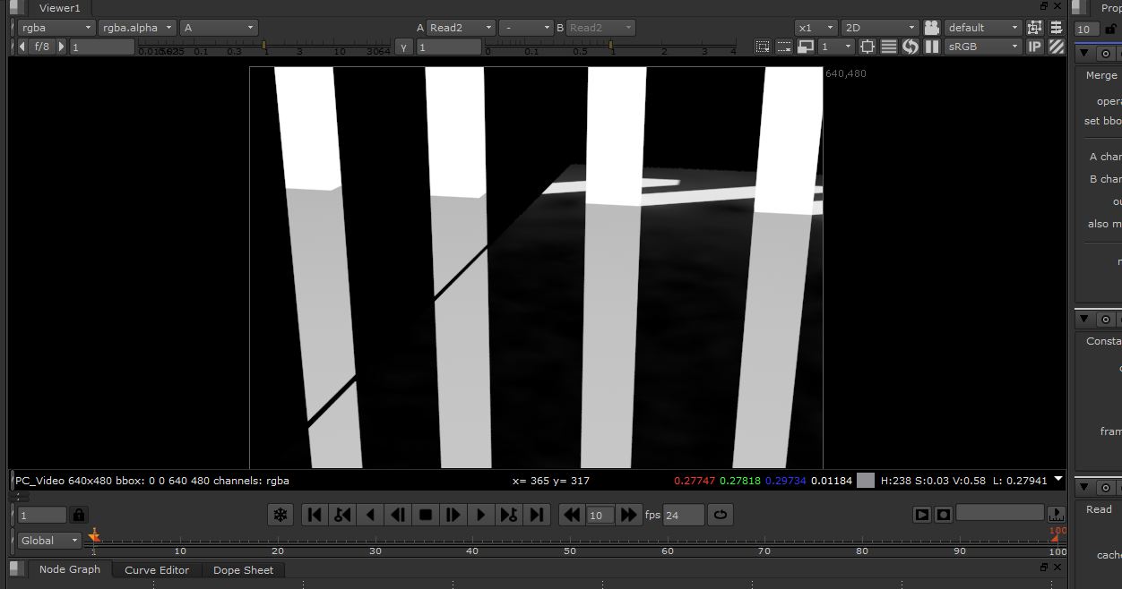

                        This is what I got from your scene with version 3.00.08 without changing anything but the output path:
                        RGB:
                        Alpha:
                        And this is the result when I compose that RBG-pass with another image (RGB=255,0,0) using over-operator.
                        Both reflections and shadows are there.
                        Can you show us how the things looks like in your environment and what compositing software are you using?
