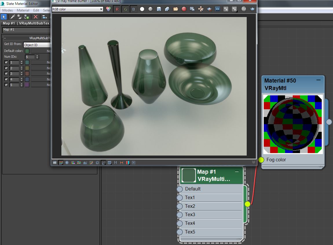

    When fog color texture is set to VrayMultiSubTex- Vray production renderer takes into account only default color of MultiSubTex.
    VrayRT renders this properly.
    By the way - when fog color texture is set to MultiTexture (use color switch is ON) max crashes.
ID:	881030 Click image for larger version
