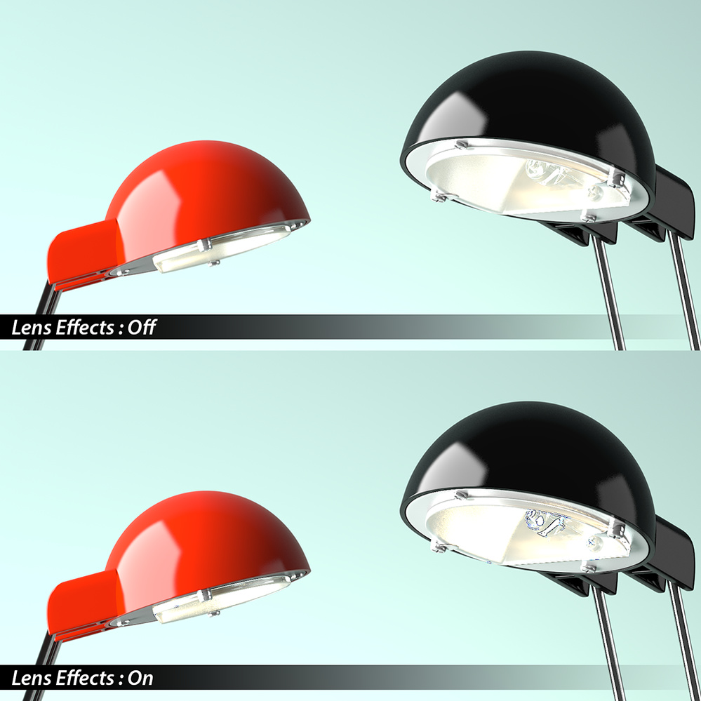

    I have been trying to use the Bloom and Glare Lens Effects for a while without success. They did not work in my original install of Vray 3.0, nor do they work in the new build just released (3.10.02). I've even downloaded a sample file from MintViz from a tutorial they have for setting up Bloom and Glare. The render completes normally, but after the lens effect calculation, there are strange dark blue outlines around everything. The file I am using can be found here.
    http://www.workshop.mintviz.com/tuto...-lens-effects/
    Using 3ds Max 2015 SP1 + Extention 2 on Windows 7 Professional SP1 64 bit. Please let me know if there is more information I can provide about my setup to help troubleshoot this.
    Thanks everyone.

    Are you using the 3ds Max VFB or the V-Ray one?
    Vlado
      Using the Vray Frame Buffer.
        For the V-Ray frame buffer, use the lens effects controls in the frame buffer itself:
        http://docs.chaosgroup.com/display/VRAY3/Lens+Effects
        The Render Effect will work only for the 3ds Max frame buffer.
        Vlado
          Got caught up with the holidays. Thank you for clarifying. Works perfectly now.
