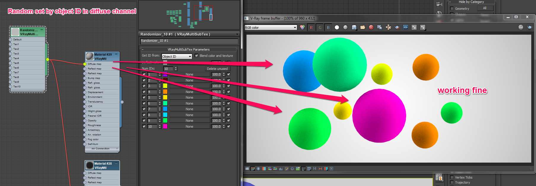

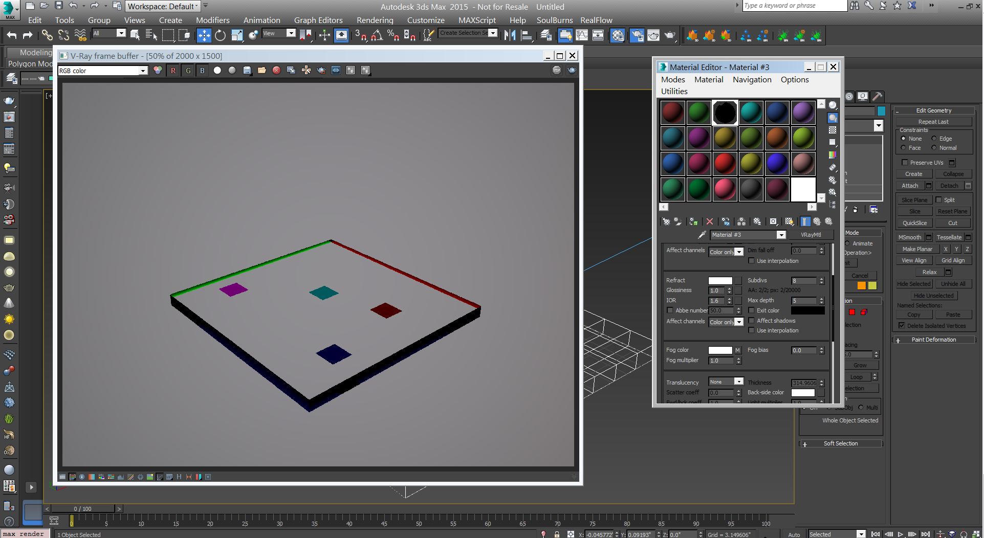

        Try changing the the "Get ID from" to Random by node and you'll see it does not work.
          Here are some screen grabsClick image for larger version
ID:	854986Click image for larger version
            I managed to reproduce that - thanks for the clarification.
            The following modes of VrayMultiSubTex do not work inside FogColor slot of VrayMtl:
            Object ID / Random by Node Handle / Random by Render ID / Random by Name
