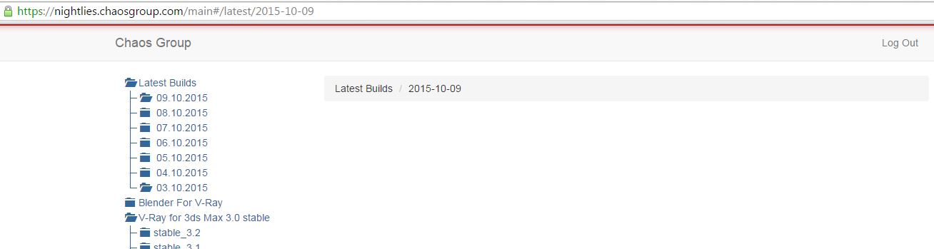

                    I can't download nightly by the way, the Click image for larger version
ID:	858546folders are empty.
                    • #25
                      That's why I asked you to email our support guys for access to the nightly builds (the actual nightlies, not the stable ones).
                      Vlado
                      • #26
                        I did, they gave me this link. I'll email them again..
                        • #27
                          Ok. Please include me in CC too.
                          Vlado
