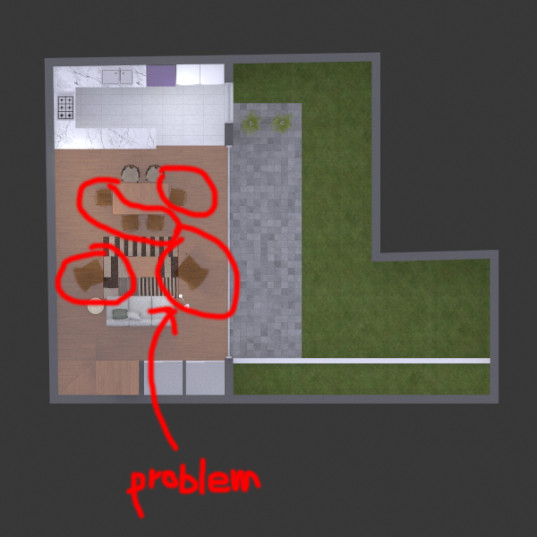

    I have a problem when i render with a orthogonal max camera and vray exposure control, objects don't render, just shows a burn area where the object its suppouse to be.
    3dmax 2011 x64, latest vray3, DR or local doesn't matter. The Multiscatter guys address the problem to vray.
    To what email should i send the scene?
    Thanks

    move the camera away the geometry in Z-axis, it should solve it.

      If moving the camera doesn't solve it, then it would be best to get us some example scene to support@chaosgroup.com so that we can fix this.

        Hi Vlado,
        Moving anywhere doesn't solved, i sended an email to support.

          Maybe try increasing the target distance and then change the FOV, see if that randomly helps....
