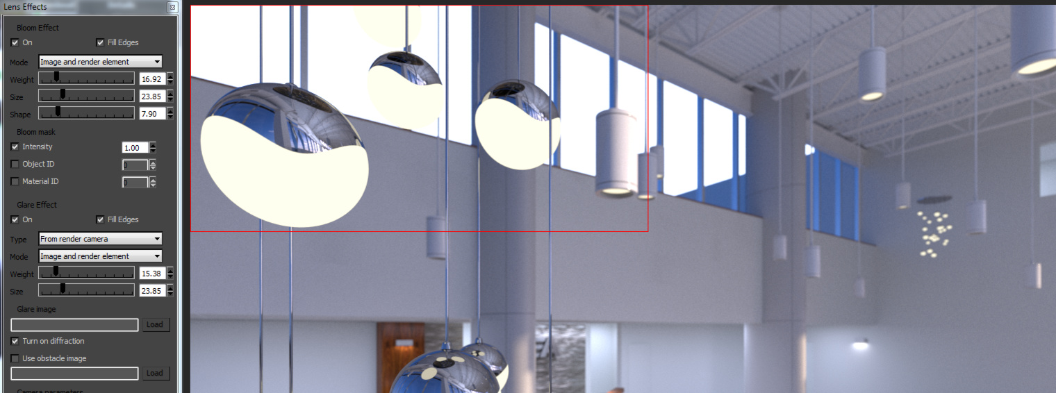

          I cannot get anything but black, when I use intensity masks. I've tried a good range (1-3) and it just comes all black.
          And there are plenty of areas in the unclamped render that are well above value of 2.0)
          The lens effect obviously does nothing to the image unless un-checking the masks completely.
