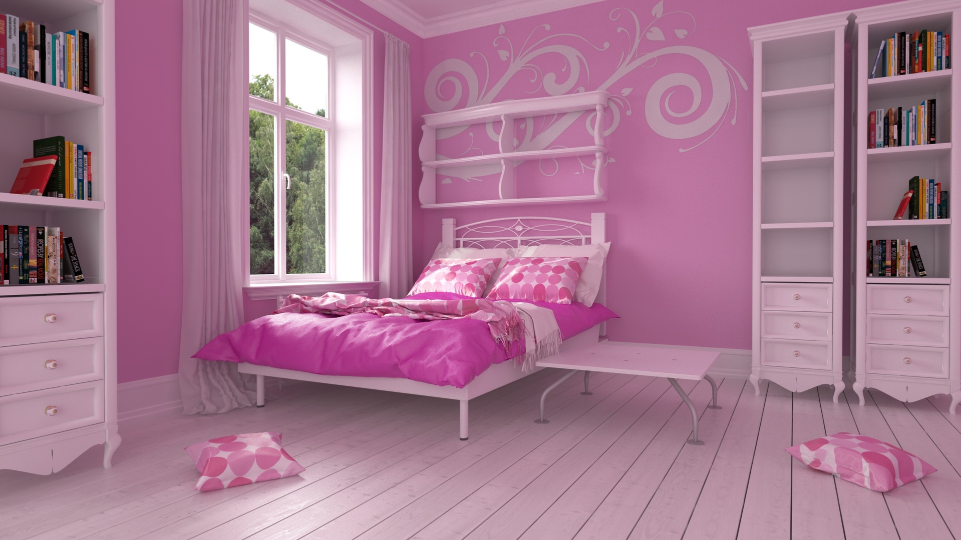

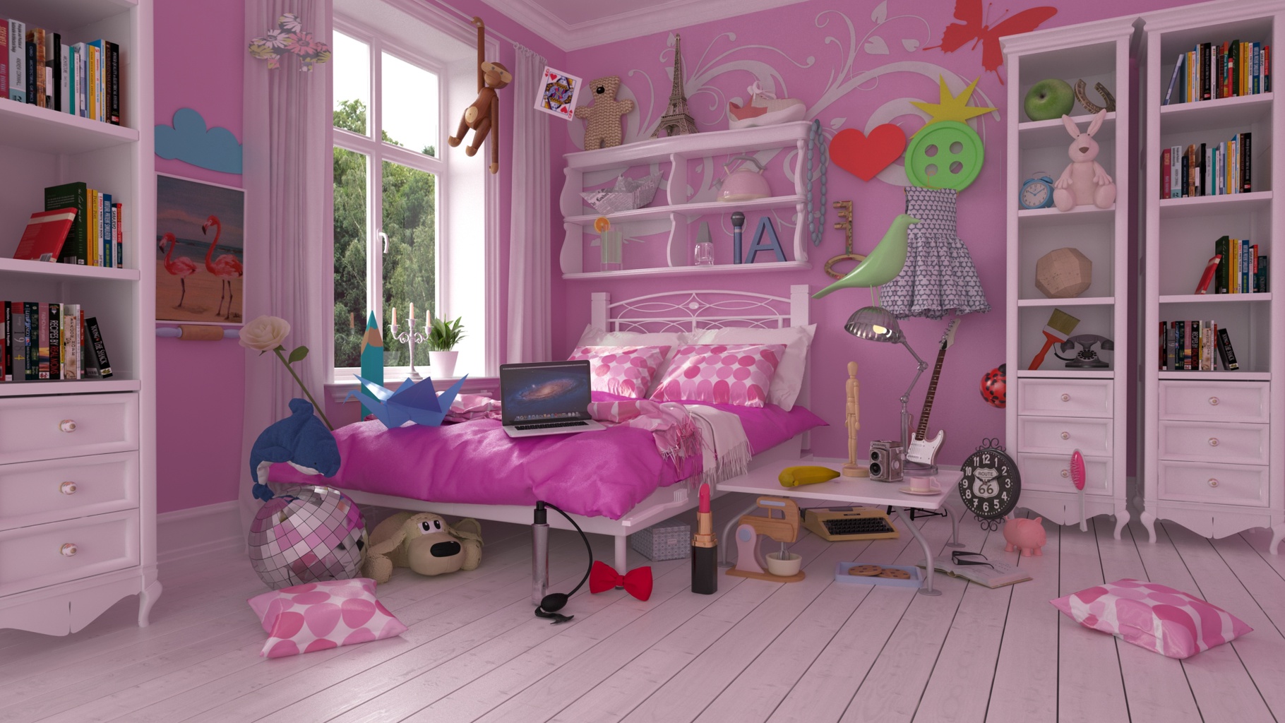

    I'm working on a find an object game, and i'm supposed to make all of the 3D graphics. The thing is that i'm supposed to make it easy for the photo shop guy by making an empty scene ( only the basic room elements, without any objects that are supposed to be searched ) , an full scene, and the part that i'm having problems with, the only elements with their shadows scene !
Name:	puna soba sa drvetom.RGB_color.0000.jpg
    i have tried lots of different vraymtlWrapper combinations, but nothing is working for me because i have to keep the light source and wall colors but they must not be wisable
    I have read lots of tuts, tried them but i can't get it right,
    Has anybody had a similar situation?
    gamma is -1.0 and all the ticks are on....
    any response is very valuable!Click image for larger version

    Would it be possible to simplify the things by sending us a very basic scene and explain us in details what exactly you would like to do and what exactly is the issue since we are not sure that we understand you correctly.
    We are looking forward to hearing from you.
      Do you need the shadows for each object separately? For for all of them together?

        Hello,
        yes i'm sorry i didn't reply yesterday , i updated to the latest version and im yet to try it again. I'm thinking of the easiest way of doing this and i think all objects together and their shadows would be great, it would be even more great if shadows would keep the colors
        then i would save it in PNG and marge them in a fresh scene with no objects so they will later in Unity be made active
