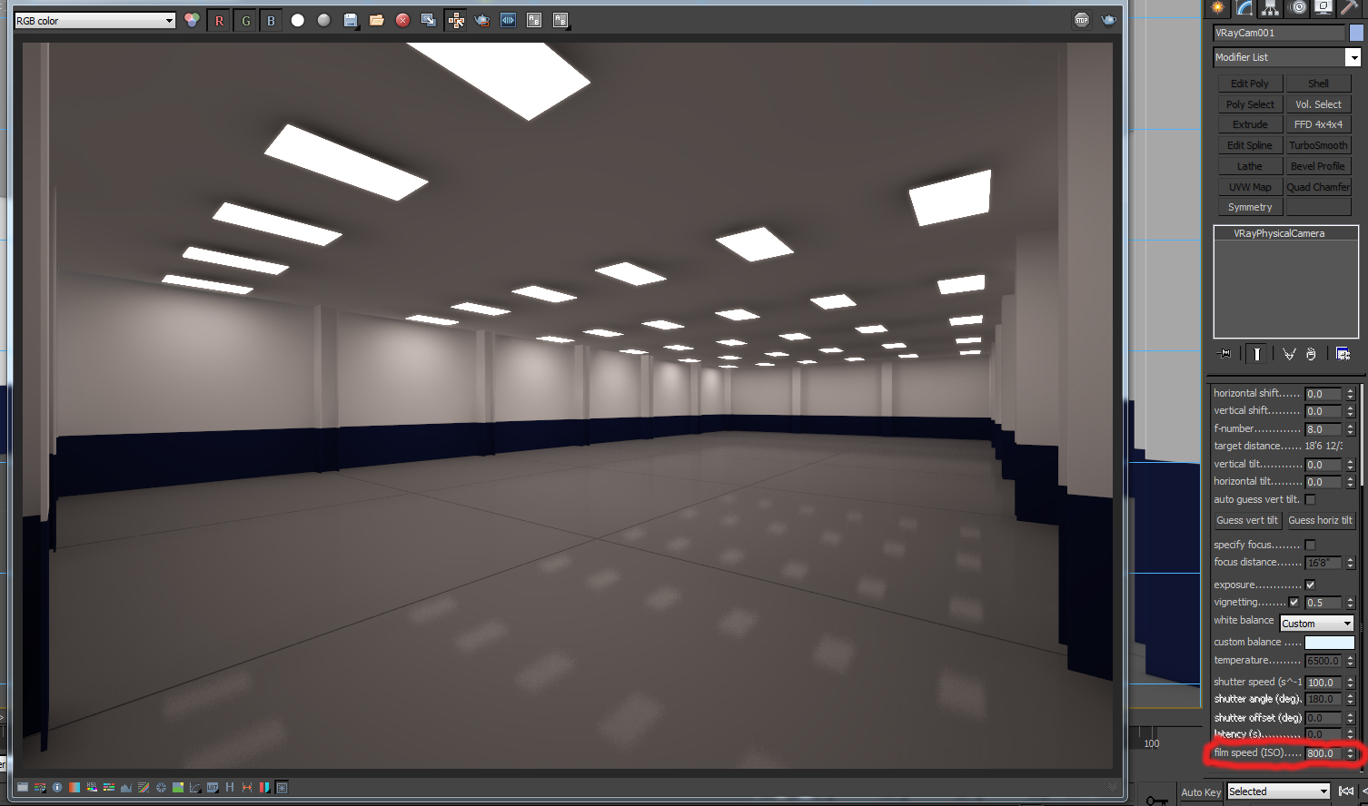

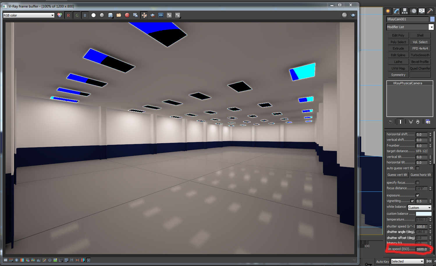

    I notice that when i increase the camera Iso, my light color changes in the VFB.
    however when i save the files the color is ok.
    see attached images
    Image 1, ISO 800 . Light Color White
    Image 2, ISO 1600, Light color Cyan, Black, Blue
    Thanks
    Cecil
    Have you checked the sRGB button?
    sorry, it's correct what said below ..it's the clamped color button
    Alessandro
      Is clamped colors checked in VFB?
      A.
