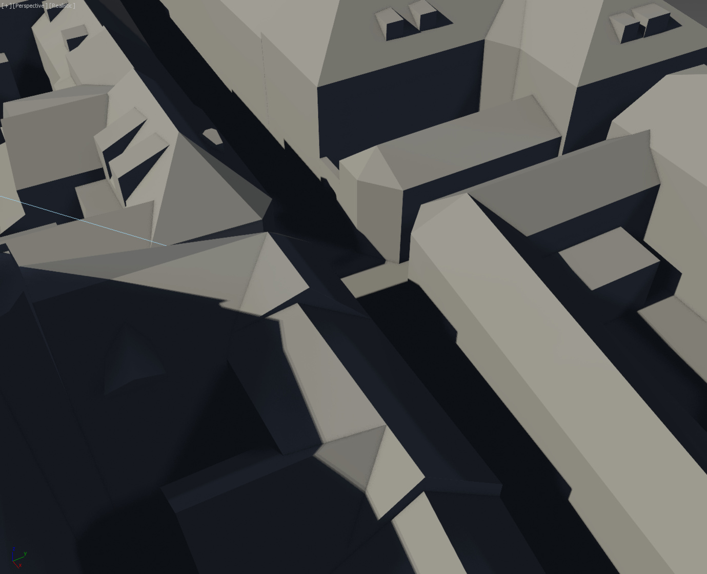

    I've been experiencing some difficulty on large scale scenes with VRaySun and realtime shadow display.
    When setting a daylight system to mr Sun the shadows are perfectly crisp, but when setting it to VRaySun they become very low res and blurry with stepping and artifacting.
    Is there any way to fix this, as I now find myself switching back and forth between the two between working and rendering.
ID:	855946Click image for larger version
      VRay Sun+ Vray exposure control on the left, mr Sun+ mr exposure control on the right.
      Scene attached.
