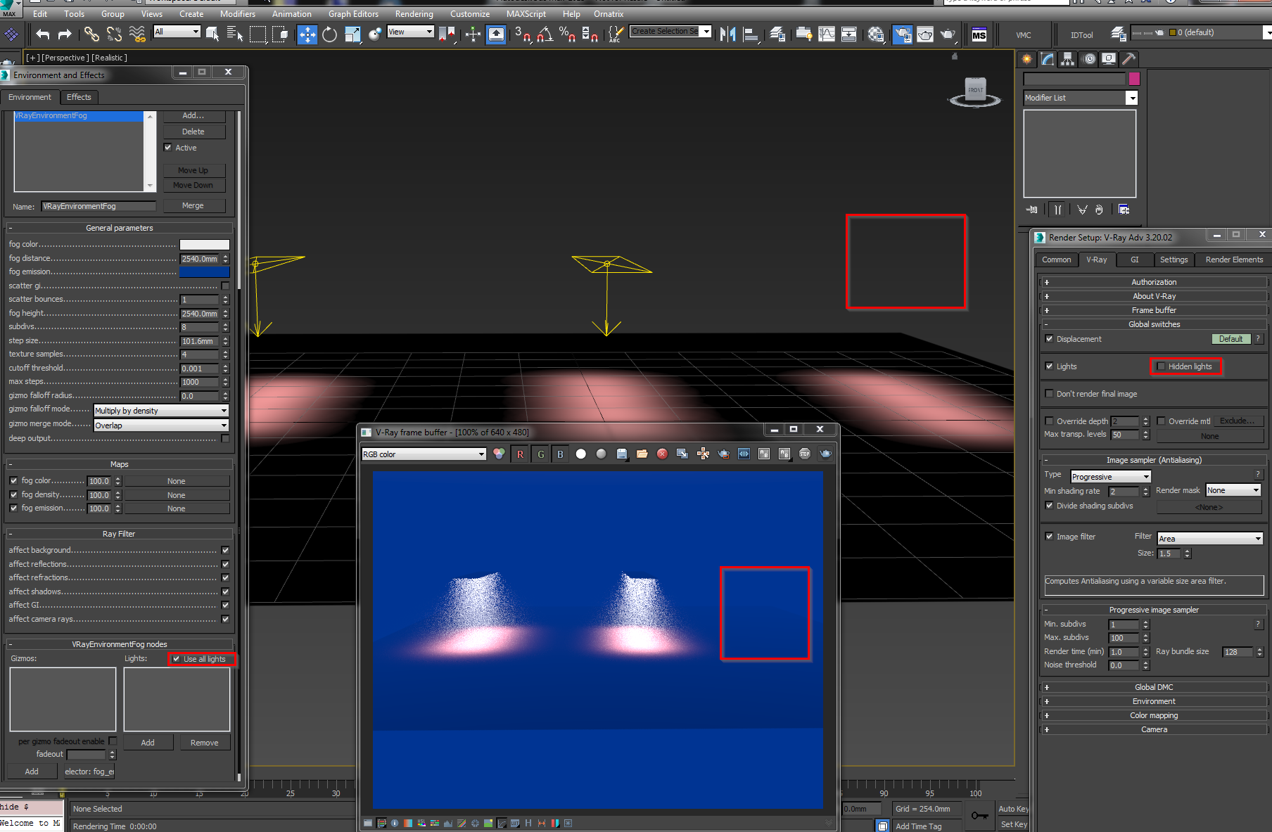

    Hi Steve,
    Point 1 is already added in our dev. system and it should be available at some point.
    Regarding point 2, actually I'm not sure if I haven't missed something, but here is the result that i got:
    V-Ray 3.20.02
    Have you disabled Hidden lights from the Global switches tab?
    Tashko Zashev | chaos.com
