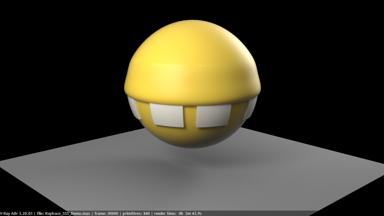

        The artifacts present in Raytraced mode seem to be related geometry intersections, and objects registering within a surface when close to the surface. There is also increased shadowing/occlusion surrounding these intersections. I will put an example together today to demonstrate.
        I'll also include both scene files, we are currently using 3dsmax 2014, but I also tested in 2016 and the issue was also present.

          Here is an example of the artifacts I was refering to, images and scene files attached.

            Ok then, what you can do is ask at support@chaosgroup.com for access to the latest 3.2 stable builds; select the SSS object and the penetrating one, and in the V-Ray Object Properties dialog give them the same Raytraced SSS ID (f.e. 1, as in the attached screenshot). It should work better (or at least as good as I can make it now).
            This change went it after the official builds were done.
