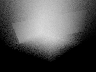

    The Vraylight planes are affecting the volume fog. I'm seeing hard edges in the fog where the lights are even though they're set to invisible and not included in the volume light list. I think the problem is that they're casting shadows not the light casting shadows but the object itself is casting shadows. Is there a way to disable shadow casting for the reflection card geometry?

    Would it be possible to send us a example scene and a screenshot of the result you got into your environment?
    Thank you very much in advance.
      Normally it goes darker, but in my example scene it went lighter. \_(ツ)_/

        Thanks for the scene - it looks like a bug.
        I'll make a note about it into our system and I'll let you know when I have some news about it.

            Our developers are still working toward resolving the issue.
            We will post in this thread as soon as we get any updates.
