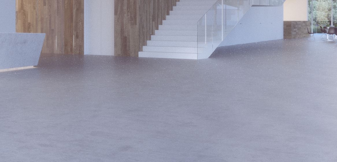

    Lately, I have been getting those little white specs in my render. The specs are in the reflections and raising the subdivs does not help. I am using IRR + LC and an HDRI. I turned on subpixel mapping and the HDRI is invisible, however, I am still getting the specs.

    Ive been plagued by those a lot lately and its becoming a serious problem even with using Max Ray Intense that often doesn't get rid of them all no matter how high or low I take the value. One thing that did work for the most part for me was in the vray material under the options tab changing the Treat Glossy Rays as GI to Always if I remember correctly.

        What kind of material do you have there? Any GGX BRDFs involved?

          Yes. I use VMC to set all my materials to GGX BRDFs.

            Ok. Next question: is there anisotropy involved?
            Vlado
              I don't think so, unless it is on by default

                It is off by default.
                Which V-Ray version is that, is Max Ray Intensity of any help?
                Can you attach the scene so we could have a look what's going on?
