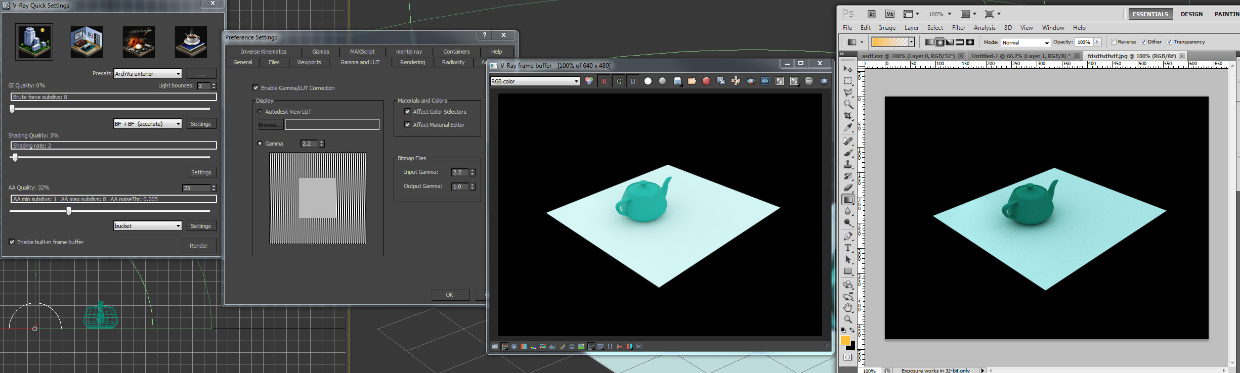

I'm getting a weird gamma issue with 3.2003 - Max 2012. Sometimes the gamma drops out within the frame buffer as well. Doesn't matter if I overide the default gamma values when saving to jpg, tif, or png. Saving to floating point .exr saves as expected (same as vfb) I even tried loading ICC to see if it need that, but it still saves out differently. Sooooo I'm a bit baffled here.

No, it's not a photoshop issue, nor any other image viewing application issue. It's an issue with the vray frame buffer not saving out what it's told to
It seems to be tied to the "quick" vray settings panel - I thought I made that clear with the initial attachment, but I guess since I only have a handful of posts here nobody thinks I know what I'm doing...... Is an essay with footnotes required?

The screenshot attached shows that the Output Gamma is set to 1 and most probably this is the reason why the saved image files are with different gamma compared to the V-Ray VFB. Setting it to 2.2 should give you exactly the same image on both screens.
Our VFB shows the final render image in sRGB space - "Display colors in sRGB space" is "On" by default.
Photoshop uses different profiles based on what bit depth you rendered to, so it wasn't out of the question. That explains why your exrs work and your others didn't, but overriding to 2.2 is probably it, as suggested. Best of luck.Last edited by Deflaminis; 01-09-2015, 06:53 AM.

Originally posted by rusteberg View PostI anticipated that and still find the output not to line up when saving below floating point..... Here's an example:
The best way to compare both images is to save EXR 32bit file and open it in Nuke or any other software that has support for sRGB profile.
Another approach is to disable the sRGB from the VFB and change the 3DS Max Gamma output to 1 and they will look the same again.
Please make a test and let me know if you still have problems to get identical results.
